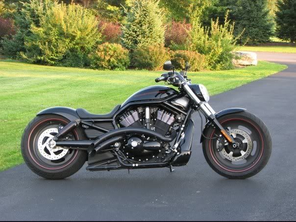

  • hquick
    hquick
    How difficult to make your own pipes? What's involved in the mufflers for these bikes?
    I built a twin 3" stainless system for my Chevy Suburban....and have also been wondering what to do with my 09 Muscle when I get it.
    Saw/heard one the other day with the VH pipes same as in that pic. Sounded nice and looked good....but I like to build all of my own stuff.
    I'm thinking something like the Big Rig pipes in stainless....and maybe black ceramic coated?
  • hquick
    hquick
    A few pic's...what do you guys think of these?
  • Mr Night Rod
    Mr Night Rod
    Yeah Awesome pipe's they look LOUD !!!
