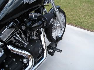

    Got ant photos of said brackets........just for future reference ;-)
  • shfunky
    shfunky
    Thanks for the photos mate, looks like those brackets have done the job. Might make some up anyway, would rather not scrape the bastards. Yours look good by the way. Close ups would be good if you can.
