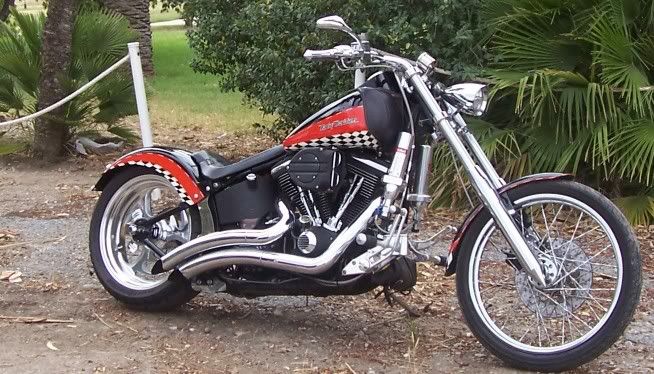

    I have attached two photos to this reply
    The bike is a black 2007 superglide that has been dusted with rainbow flake, in low light it looks like a black metallic job, but in direct sunlight or street lights, all the colors come out.
    The photo doesn't show the effect properly.
    The second is the new seat done in metallic vinal
