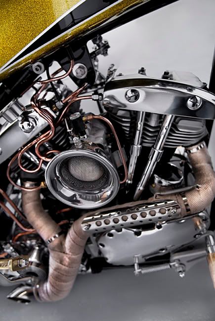

  • shifta
    shifta
    I fited one to the gold bobber with the genny shovel, was a good thing, had noticeable mid range improvement and over all a better thing to ride!
