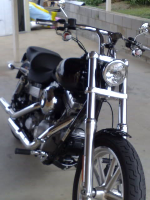

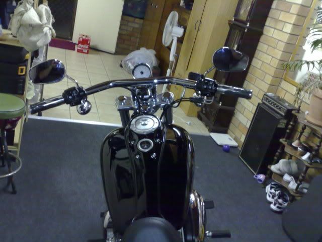

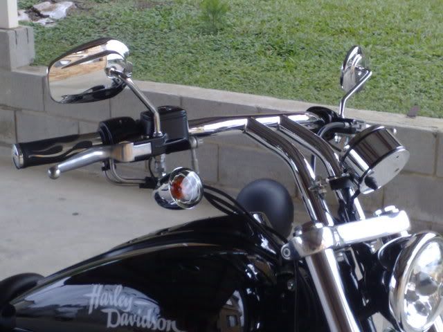

    After many hours much swearing, and a hand from mate who is an auto lecky because I suck at soldering and pretty much all things electrical. The son inlaw and I finally got the bars finished.Will post pics soon . Cheers for info posted to my question.

    nice job mate :)
