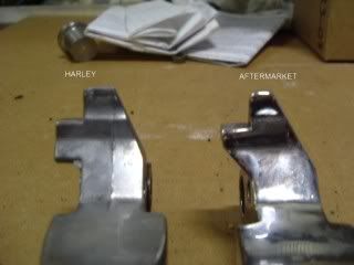

    I looked into mine today, I think I know why the boot is torn and my lever is flicking past the switch
    The after market chromed levers tang is not wide enoguh to engage the switch properly.
    I have put the stock one back on and problem solved

    I'm having the same brake light problem at mo with aftermarket levers - brake light stays on all the time. It was working fine for several months but I guess the new lever may have worn the hole in the boot ...why don't they tell ya there might be a problem before you buy these shiny bits??!!
    I get the same clicking sound described by black29d. Apparently, you can't just buy a new rubber boot for the stop switch, my local stealer tells me I need a whole new switch - cost is $40.
