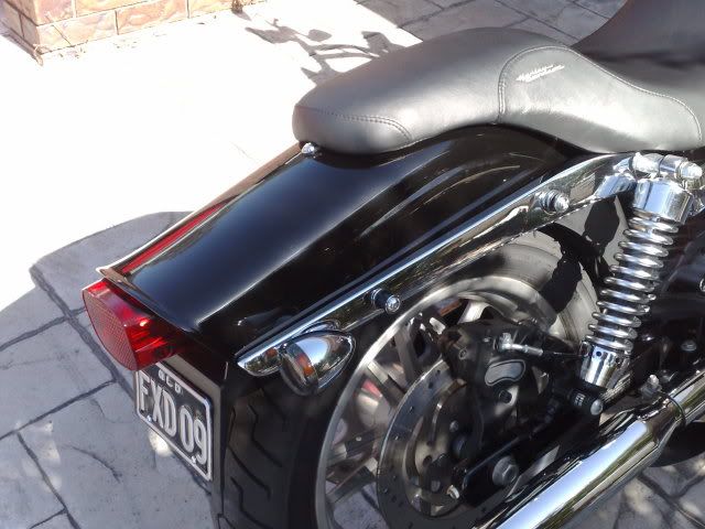

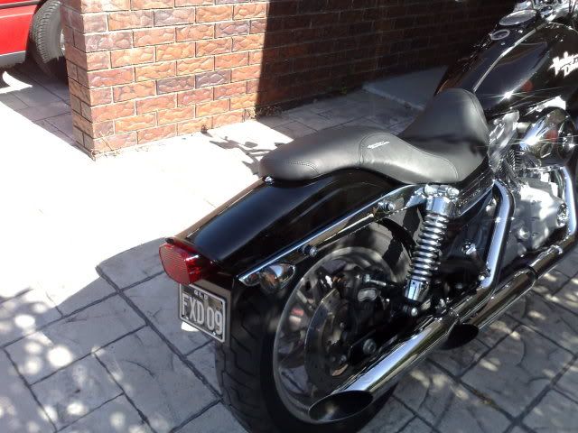

  • FXD09
    FXD09
    Finally done it

  • kickinon
    kickinon
    fxd09... sure looks a whole lot better than the std dyna guard,
    well worth the outlay i'd reckon....
    good stuff!!!!!!!!!!!!
  • GUN100
    GUN100
    Hey Dude looks great, where did ya end up getting it from
  • FXD09
    FXD09
    Local dealer mate
