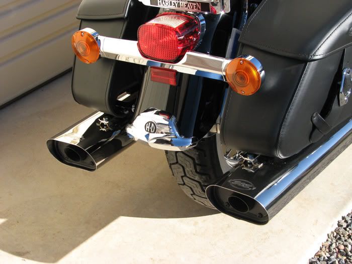

    I have used S&S oval mufflers on all my baggers and found them to have a pleasant bark without the headache inducing loudness when on the long haul trips around Aus. They fill in the with of the bags bags as well.

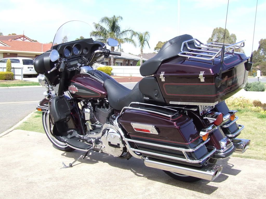

  • twincam88b
    twincam88b
    I also have the S&S ovals on my 08 Road King. They sound pretty good, deep and not too loud, hopefully won't attract the plod. Also have the aircleaner and download changes. The pipe "poofer valve" has been blanked off. I like them....TC
