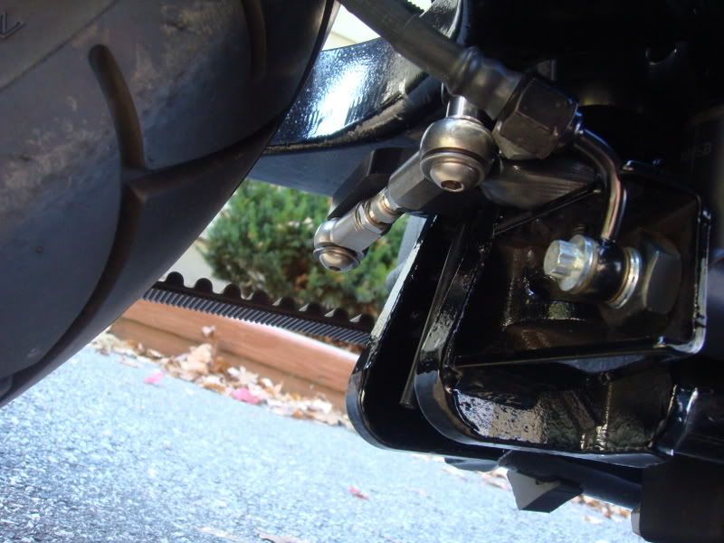

    I have them fitted and because I have had other issues to do with handling cannot comment a great deal but have read that they can make as much as 30km/h difference in cornering speed.
    There were issues in fitting.... not that on the front unit the locknut is very close to the frame. Under hard riding it can bounce against the frame. Mine is ok but other have had problems and have revered the bold. Also note that the rear brake sensor is very close to the turnbuckle. This may also cause problems. I very carefully repositioned the sensor to have the sensor facing down at 60 degrees. Note that on the 08 Dynas they have a sensor mounting directly onto the brake piston housing. Will be doing this when I buy my braided lines.

    Have just ordered mine from Mackay Motorcycles, I'm told that the latest version for the Dyna (rear) has been modified so as not to interfere with brake sensor etc, still might have to turn the bolt around on the front mount though.

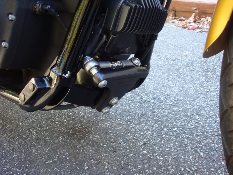

    I put the front part of the true track stabilizer on and went for a 100 k ride Ok I didn't get time to fit the both front and back stabilizers before I had to ride to rehearsal, so I took a punt it would be ok to ride with just the one on.
    As soon as I started my bike up I noticed less vibration on the bars at idle, my bike used to vibrate quite badly at idle and at the slower speeds, 40k's 60's etc now it doesn't.
    Now It feels the same vibration wise at 40k's or at 120k's.
    It has a different feel to the bike when it revs out its like I can feel the motor better through the pegs so there are some transfered vibrations that come with the true track but nothing like mine was standard, its seems to be a higher frequency vibration easily handleable though.
    I will update this once I have put the rear stabilizer on and given it a good flogging thru the twisties

    Finally got the back true track stabilizer on.
    What a bastard of a job!
    Anyway its done!

    Thanks for the pointer RT, duly noted.
    I have done a couple hundred k's on her now and it really handles very good.
    Because I had to take the New members ride Yesterday I couldn't give it too much of a flogging but it definately handles like its on rails around corners.
    It handles more like it should have outa the box I reckon.
    Easily add 20 or so k's to ya cornering speeds.
