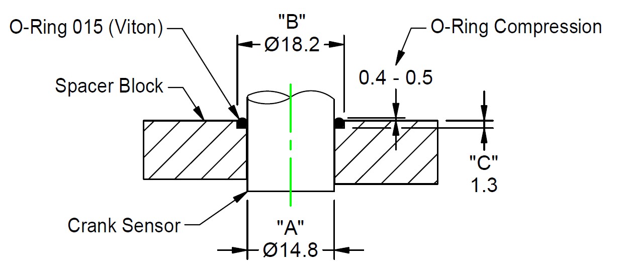

    Future reference for HD-11170
    Measured the Sensor and groove to determine the correct o-ring,
    Crank Sensor spigot "A" = Ø14.8
    Spacer block groove "B" = Ø18.2 x  "C" = 1.3 deep
    O-Ring Number 015 (Viton)
    (Ø9/16" x .070") I.D. 14.3mm x 1.78mm

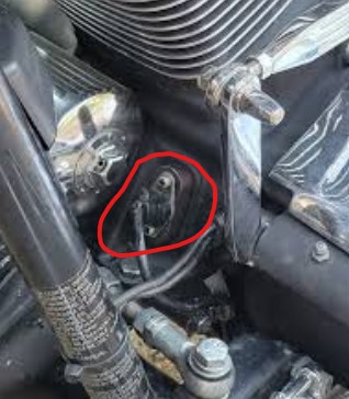

    Ive gotta ask... what Evo crank sensor are we talking about? They dont run a crank sensor do they? (in the same way as a TC), its the sensor in the timing cover?
  • wildchild
    wildchild
    19 days ago
    Quoting John.R on 12 Feb 2026 10:34 PM
    1997 EVO Crank Sensor is in the same location as the Twin Cam Sensor.

    The more you know! The thought it was EFI related did cross my mind but Ive never actually seen them or noticed them.
    Cheers!

    It does beg the question as to whats behind the timeing cover ....
    Timing cover inner, then the cam position sensor.
