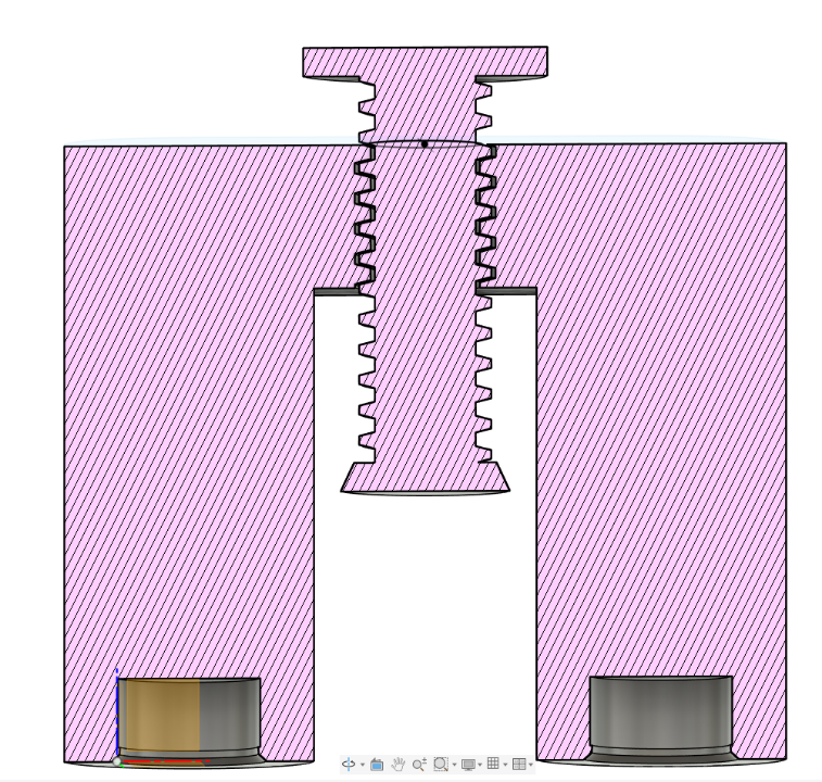

    Cam plate is coming off tomorrow, so took the opportunity to try and make a little lifter holder.
    First version came out nice, interference fit for the Neodydium magnets I had lying around.
    It was not adjustable though, so have done up a new version an inbuilt screw (acme thread), built in a way that can be printed in place.... Havent actually done this before so expecting to play with tolerances, but will be a learning experience none the less.

    Thats gotta work better than paperrclips!

    Great idea with the thread, they need good magnets and it sounds like you have that covered, I brought a commercial set of magnetic lifter retainers and found they were not up to the task, the slightest bump and the lifter would fall off, was a bit disappointed but the clips serve me well lol.

    Well the thread in place version was a fail.
    Did a new version with two separate components and and it worked.
    Havent figured out what the trick is to getting the right polarity when pressing magnets in though 😅.
    Ive been using the 10x5mm neo magnets which are very strong. Went to buy more and didnt realise how exxy they were compared to the small ones!
