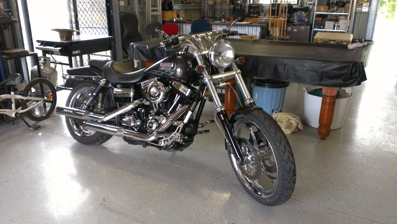

Slightly better contact patch, can run a sportier profile, I didn't notice any negatives in the 9 years I rode it with a 120 on the front.
