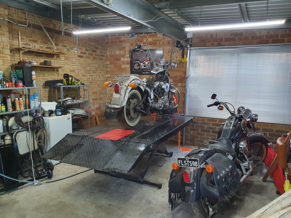

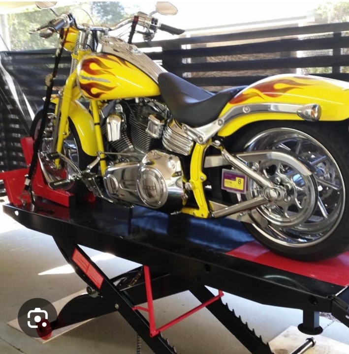

    Google up Warana Imports, I assume they’re still in business.  I use their air lifter which is much like the American Handy lift. I had the same sliding issue with my old foot pump lift but this one doesn’t budge, it weighs 200kg.
    Looks like this (not my bike, just a pic off the net, I can’t be bothered getting up to photograph mine)

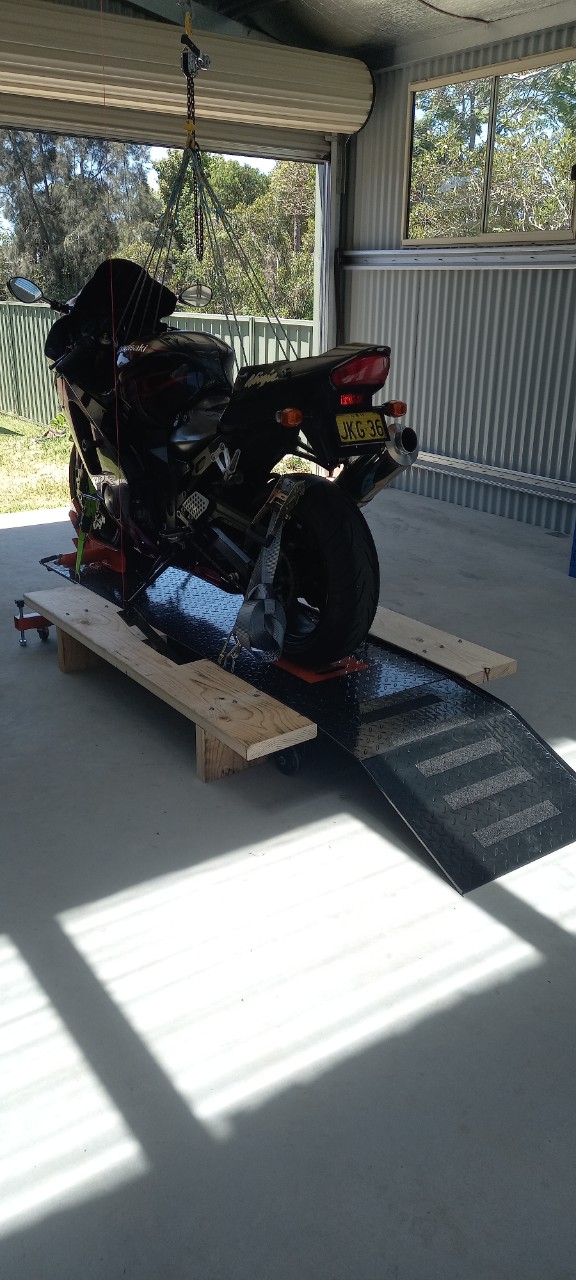

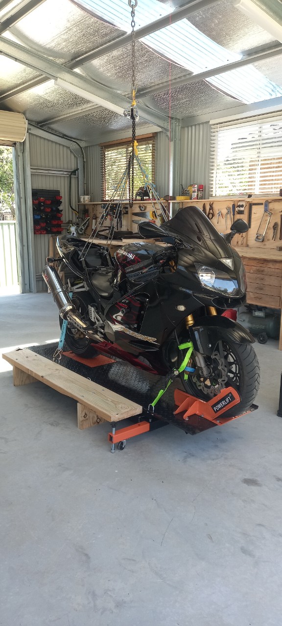

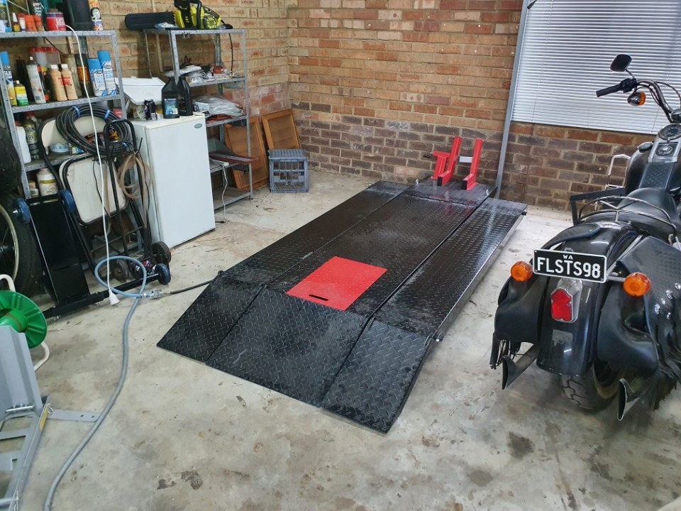

    I just bought one off Marketplace.
    There's a bloke in Maitland NSW selling them brand new for $800. You can screw the legs down before you ride up the ramp and it doesn't move.
    The table flexes a bit when the Harley is on it but nothing to worry about.
    I made up the timber platforms so I can ride the bike up and put it on the side stand,  get off and clamp the front wheel on my own.
    Pretty good for the money.

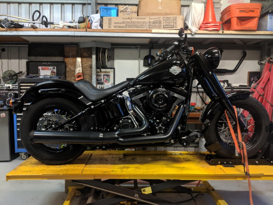

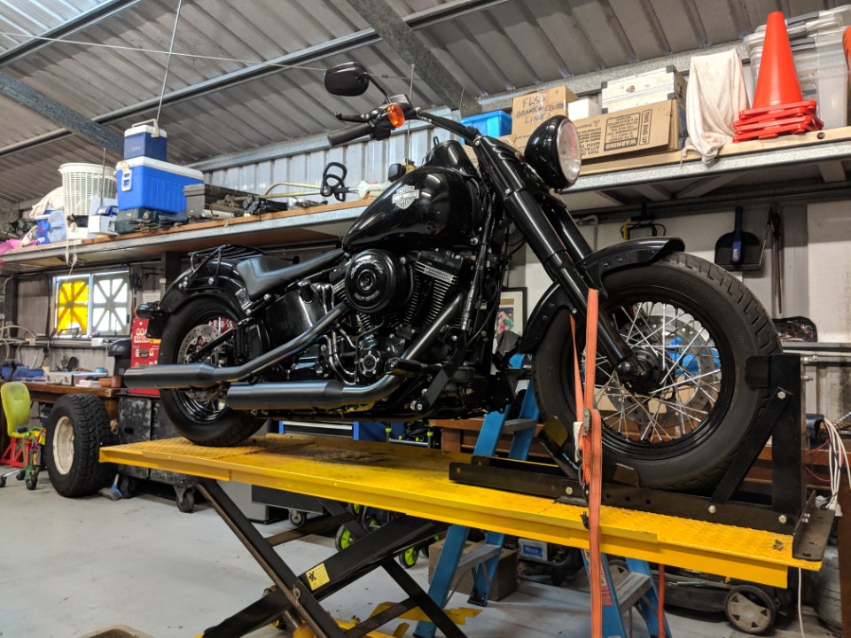

    Mine was a cheap generic one as well, I modded it to suit my needs, I extended the deck a few inches either end so my old wideglide was fully on the deck and not with the back wheel sitting on the ramp.
    I ditched the wheel clamp and used my floor steady, set it up to be quick removal so only 2 3/8 bolts have to be undone to slide it off when you want to take the front wheel off.
    Had it a long time now, had one oil leak that fixed, got it 2013, had all sorts of Harley's on it since. It does move a bit but it's solid enough for the job.

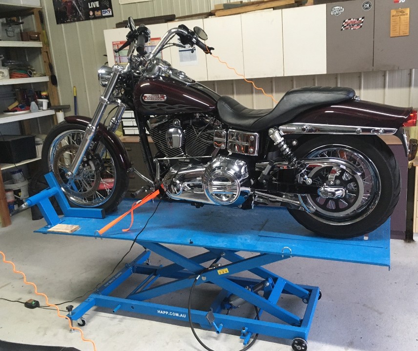

    I have one from Happ, had it for a 5 years or so now, it's not to bad, but I have few mates with ones from Warana Imports, like Rat Bob mentioned, thats the way I would go when I need a new one.

    I bought one from happ lifts, the same as benno ‘s one.
    No complaints. I’ve used it for my Electra glide and my heritage and it’s been good.
    The only advice I can give is for you to get the side extensions as it makes it a hell of a lot easier to get on and off.
    I didn’t and now I have to fabricate some . I shouldn’t be such a tight arse with money.😀
