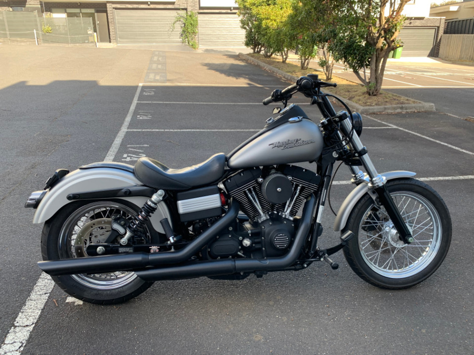

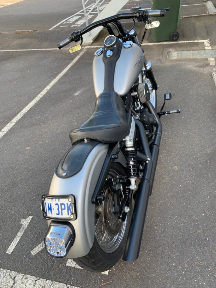

    I had a 2" lift on my 2007 FXDB and the only issue I had was with fuel crossover, had to very mildly bend the tubes from the tank so that the hose didn't rub on the frame.

    What bars & risers did you have on the '07 mate? The drag bars on my '13 FXDF look like they will hit the tank with a 2" lift, I haven't tried the mockup yet but will as soon as I'm fit again - just had my left rotorcuff recon job.

    I think 8" riser with 2" pullback. Cannot recall the manufacturer.... pics will give you an idea

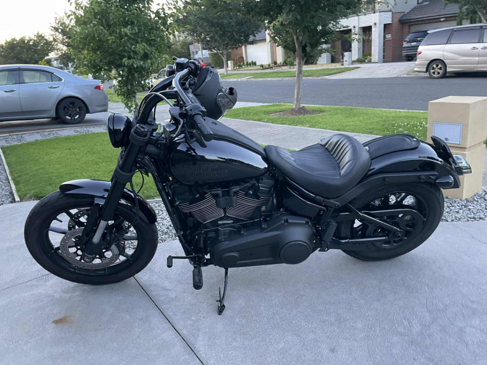

    This is my latest ride (2022 Low Rider S) after the Street Bob was a repairable write off. It is still floating around Victoria, but is now black.
    Have also been thinking about a tank riser too, just to get more air around the heads
