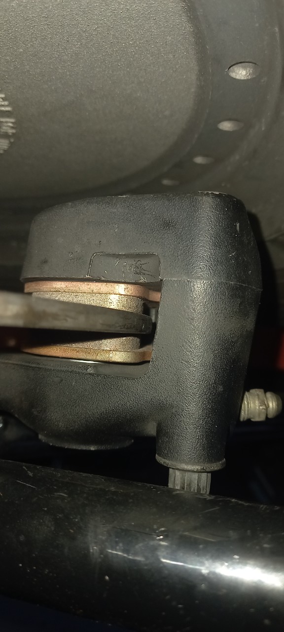

It is the one piece calliper with the four pistons that has the arm on it to mount on the axle. It hasn't been re-sealed for at least 14 years, probably never been done.

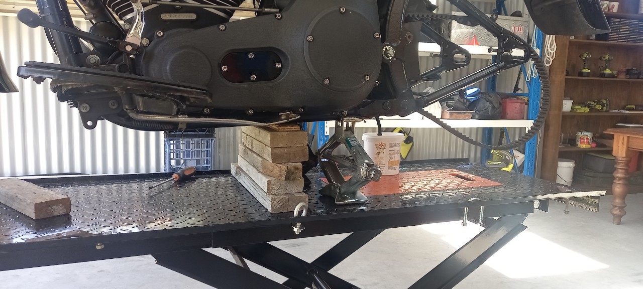

Got a question for ya Hilly.

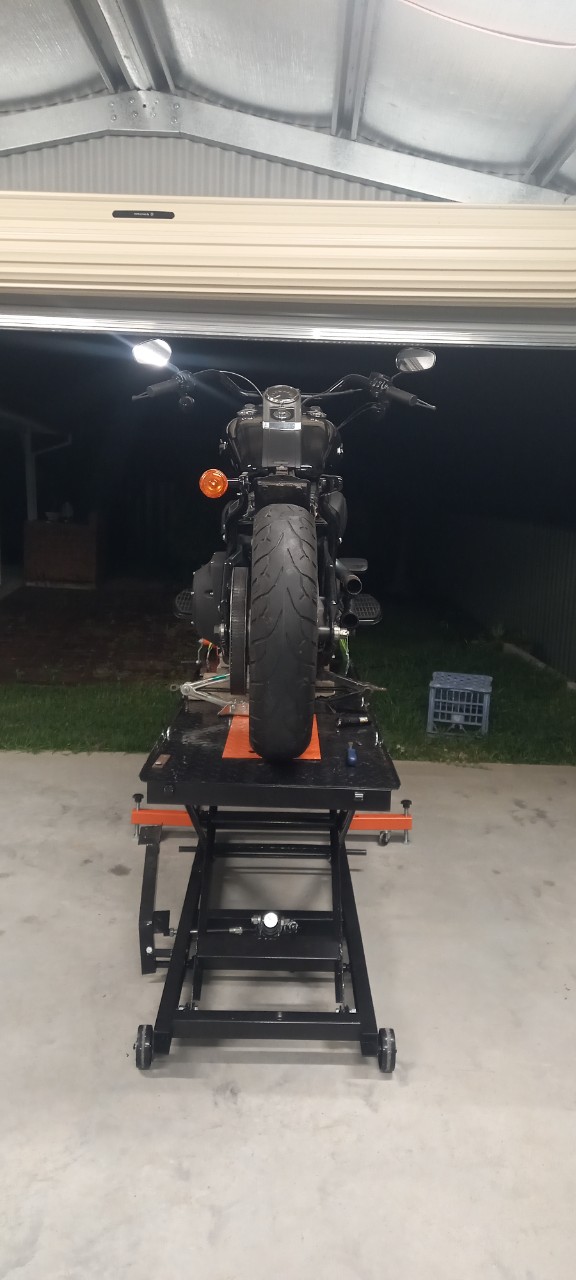

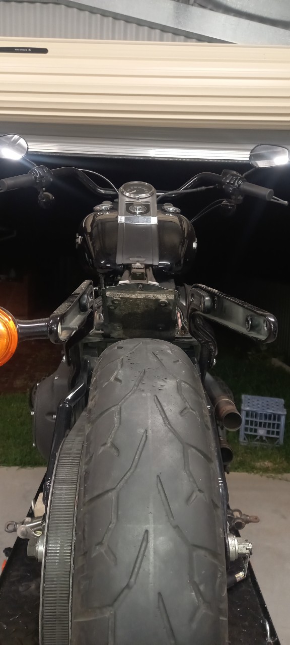

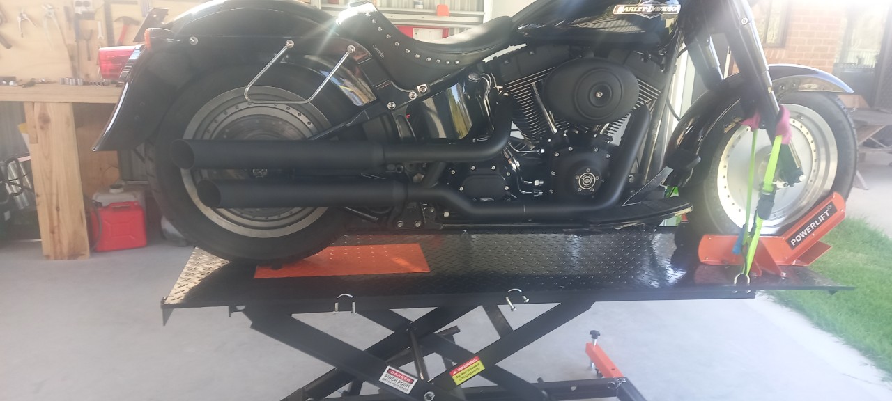

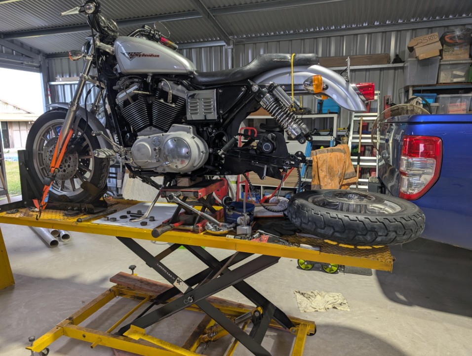

Will I be able to get the back wheel out without removing the mudguard?
I noticed you modified your hoist.
I am thinking I should make the same modification before I start this job.

Thanks for that 408. Do you happen to know how low it goes when its down and how high it is when its up?
For $60 I dont think you could go wrong.

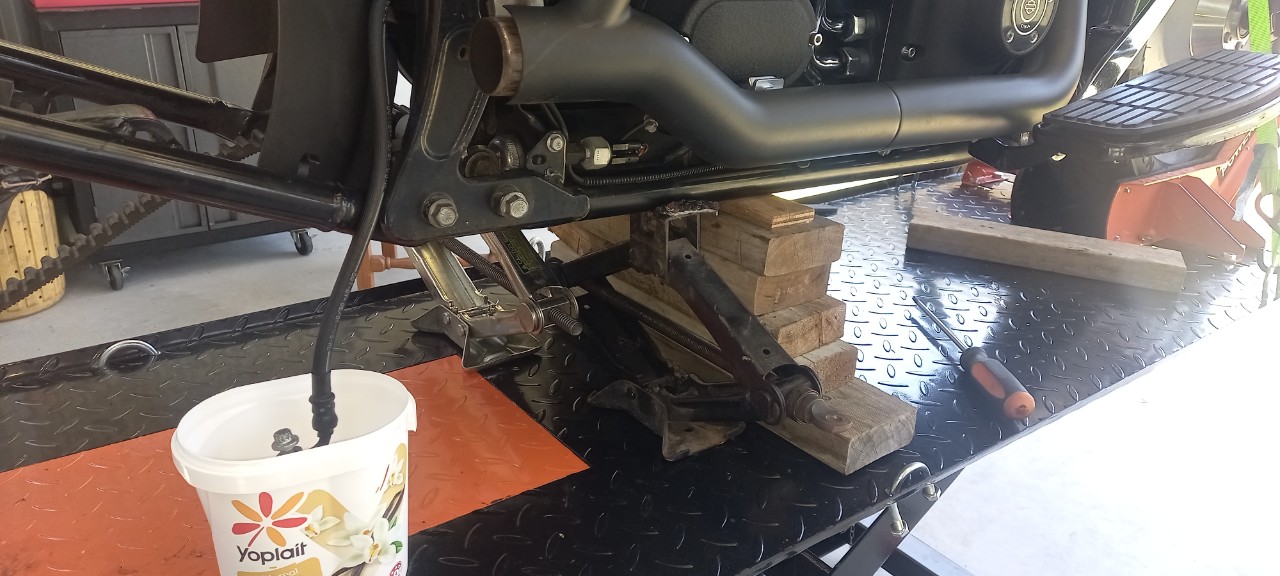

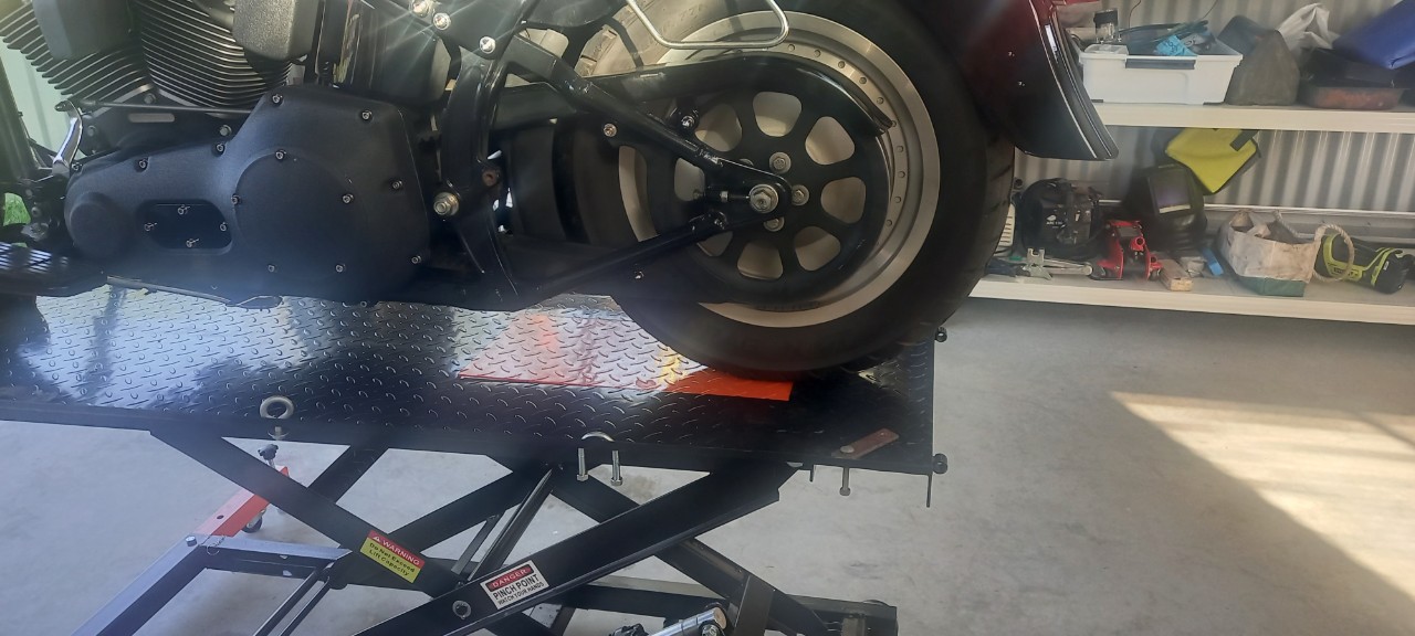

I've got the jack 408 pictured there, bloody handy bit of kit, that's how I get the back wheel off anything that goes on the lift, some bike lifts have a removable section at the rear so you only need to lift the rear wheel a little bit and the remove that section to pull the wheel backwards and down, I was going to mod mine like that but wheels and gravity ain't good for my back so I just use the jack, take the weight, pull axel etc, jack bike until I can lay the wheel over a bit and roll it out, the the back of the lift acts as a little work bench then 😁

I ended up using a couple of car jacks and timber. Probably not the best solution but it works ok and pretty stable. Didn't have to lift it as high as I thought to get the wheel out.
Went to reseal the caliper and discovered one piston in particular was seized so I am hopeful that was the culprit causing the overheating problem.

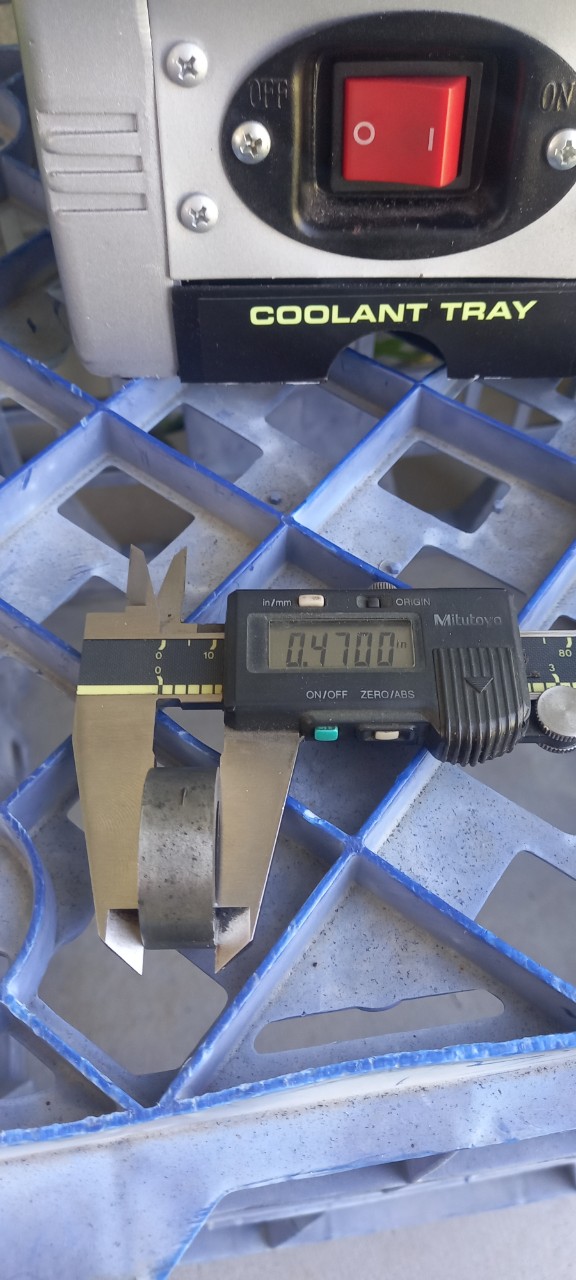

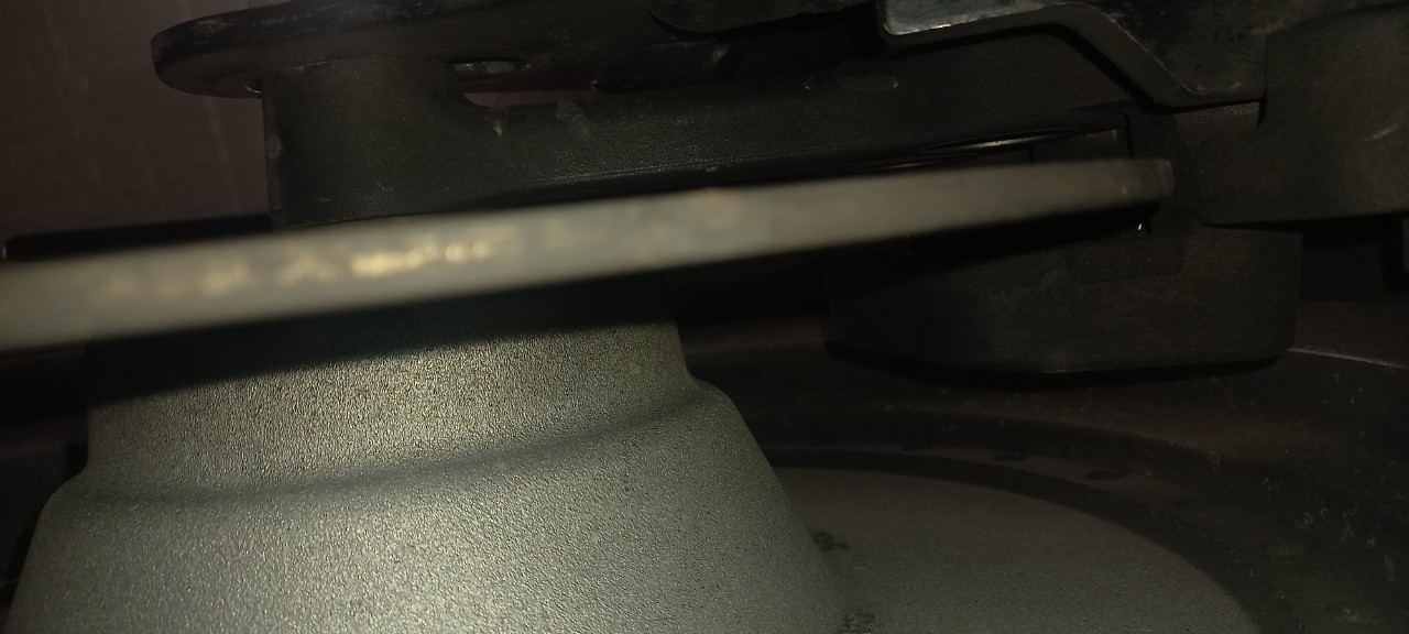

Well fuck a duck aye! Remember the rotor is outa spec as well, fixing the seized piston won't change that, if you successfully recon the caliper you will feel a pulse on the pedal when you apply the brake with that much warp.

Yeah Hilly the disc was fucked but I fitted a brand new one.

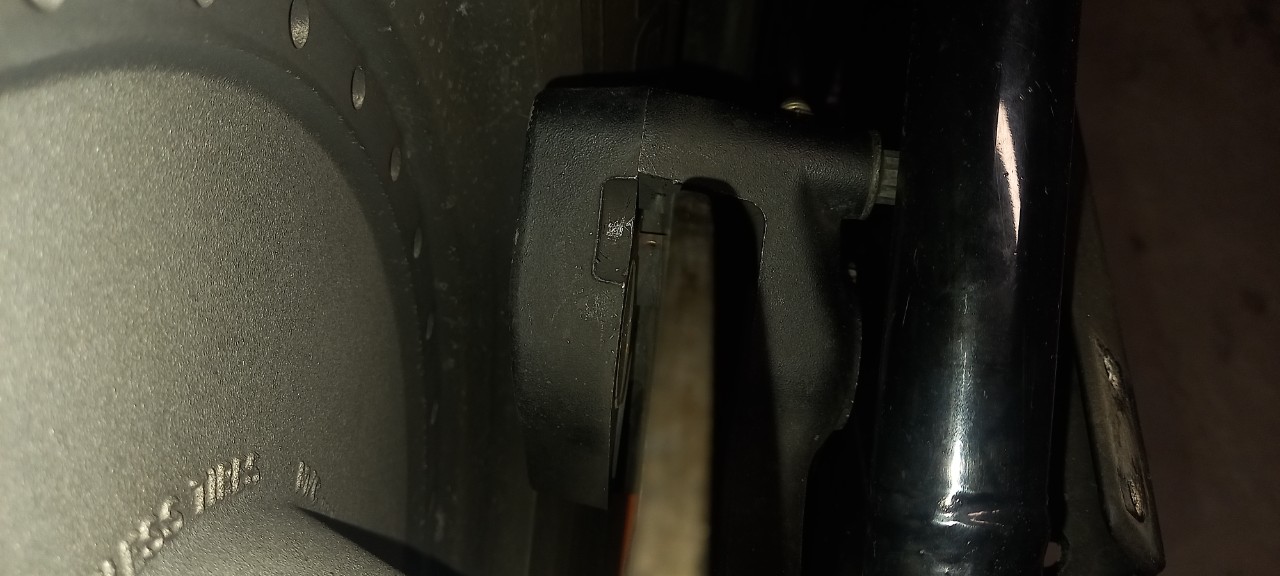

When I lifted the back wheel it seemed to be spinning freely enough but you could hear it rubbing the pads in one spot. I wouldn't have thought it was enough to make things hot but it's looking like it was the problem.
When I put it back together today I will spin it and hopefully hear nothing.
