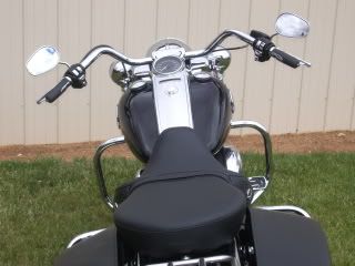

    I've purchased,  inch & a quarter wide westerns from Burleigh Bars to fit my 08 King, the dealer wants $99 an hour to fit , i'd like to do the job myself ,Dave at Burleighs says I should'nt need any extra length in fittings, I'd like to know is there any tricks in removing & replacing the electric throttle? What is the easyist way to run the internal wires, should I cut & add extra length to wires, run them through & rejoin them ? I'm also fitting aileron grips & chrome switch caps, is  there any tricks to fitting these ? any help would be appreciated as I'm 2 hours from dealer.

    I took longer to fit the bars,waiting on helpers, got them on, on sunday 9 Nov, Scotty was right, it took 6-10 hours, I was able to reuse the electronic throttle sensor, i had to extend all the other wires but not the ETS wires, the chrome caps & aileron grips were easy to fit, it looks good, i'll try to post pics soon,
    I would like to thank all who tried to help,& this forum for making it possible

    I've got pics of the bars,
