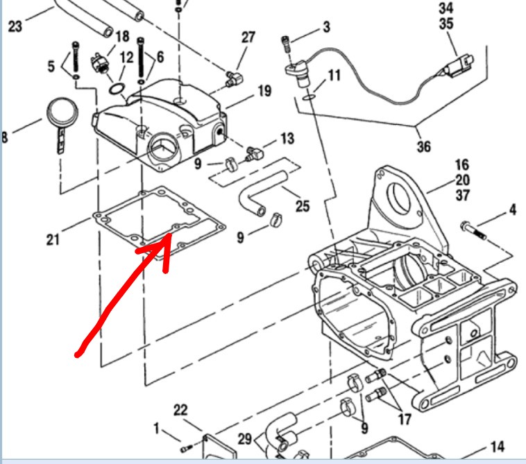

    i have been told but i am skeptical and having trouble believing,i was told that if transmition cover gasket has failed internally engine oil can migrate int transition on a dyna has something to do with dipstick passage,thats why my dye trial ended up in trans i dont believe this as it doesnt explain primary oil disapearing,im sticking with current plan unless someone pops up and says yes thats possible,i do not want to unnesesarily replace a gasket that externally looks fine,any thoughts out there on this
  • Hilly
    Hilly
    22 days ago
    In theory I guess the oil could defy gravity but in practice I can't see it happening, red arrow is the bit for reference.
  • beaglebasher
    beaglebasher
    22 days ago
    I can't say if it would allow oil migration or not but that gasket failed on my bike and created a fairly major oil leak. It must have let go when I was on the highway and by the time I noticed it and nursed the bike home there was fuck all oil left in the gearbox. I would imagine that at highway speeds there would be a lot of oil getting thrown around inside the gearbox.
  • GGUser744
    GGUser744
    22 days ago
    thats what i think its a splash system external leak, not internal engine to gearbox, I would like to know if anyone has experienced any kind of internal leak there from that gasket or was that mechanic pissing in my mates pocket.

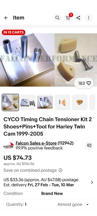

  • Hilly
    Hilly
    21 days ago
    My upgrade for the spring tensioner models would look like this pic 😁
  • GGUser744
    GGUser744
    21 days ago
    i did that 3000 km ago and hear i am with scored oil pump scored where  oil pump sits on cam plate i tried to make do last time my spring tensioners i bought still looks new if you want them i am leaving nothing to chance given my oil migration problem i think a multitude on factors from sprocket shaft seal to everything else, I believe when tensioners failed i dodged a bullet cam plate pressure falve seized shut not allowing oil to recirculate and sending oil through filter,so not doing again replaceing almost the lot,funy thing i do most of my servicing myself but tentioners not in service scedual in my manual after accident a particular harley shop in adelaid repaired it i said give it a major servise while its in there most shops i would think would say have you ever done the tentioners on thi bike7500 km later very little oil in primary compensator stuffed and cam tensioners failed tried to repair myself on a budget and hear i am 3000 km later leaving nothing to chance not that much more to upgrade unless i bought second hand plat oil pump no not this time if in smallest dought out she goes, question any other ideas im open to as im about to pucase that stuff tonight i just gotta work out how to install that sprocket shaft seal properly and buy a couple tention wrenches i cant borrow the ones i used last time
