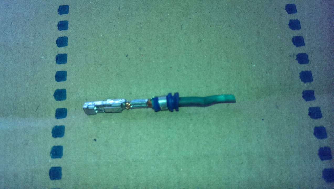

    Ok, sounds like it's not the tune side then, funny you should mention injectors, mine developed an intermittent stutter, not always there but sometimes mostly there, no codes, checked everything I could think of, I changed the fuel filter, you done that yet? Just on years it would probably be filthy, anyway I digress, turned out it was a broken wire in the injector harness right up near the plug, I had to pull on the wires to find it, years on cat trucks taught me that, you pull sort of gentle firm and if it keeps coming she broken, a pic of the culprit.

    i used to have this similar issue on an 07 dyna,a little stutter [ just once ,then fine for many km's ],not temperature or time dependant,but was more likely when warm.fitted new injectors last may and apart from a broken lead to the rear injector a few weeks later,it has run fine ever since [ i believe the lead broke from poor alignment when i reconnected after repairs,interesting roadside repair in the dark ]
    same as mine did Hilly...green wire as well.....coincedence i feel.i had a code come up for broken/loose lead to rear injector.
