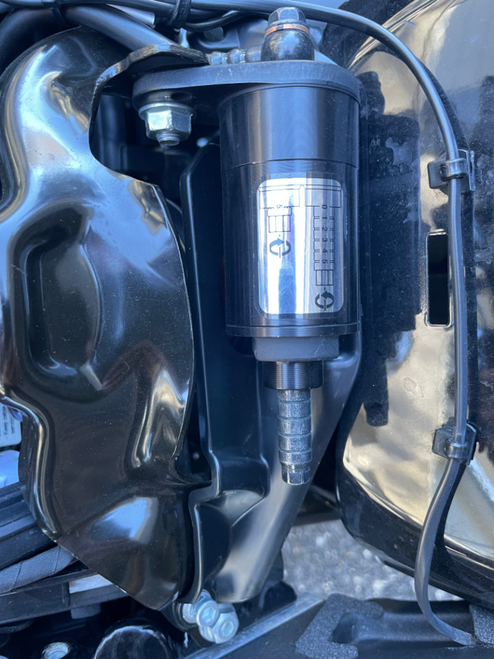

For those interested, here is a photo of of the new bracket for the rear shock preload adjuster. Basically if the bolt breaks the 'tray' stops it from dropping onto the rear wheel.

Good stuff Ho, did it take 3 months to get it? Why does the bolt break? You would think prevention would be the focus rather than a band-aid.
2 months
Hey Hilly.... ordered the part 20/08... dealer advised they received 2/9... weather has been shit so didn't get the bike to them till 6/11.

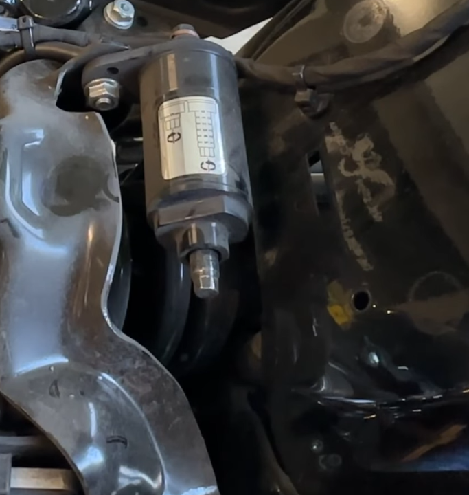

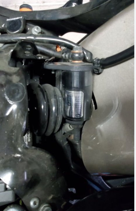

Not sure if affected by stock seat, but suspect so, the rear shock preload adjuster sits very close to bottom of the seat and any extra pressure could break the bolt and then the preload adjuster is left dangling and have on occasions lodged against the rear tire. Their first fix was to install a larger bolt, but I guess it didn't fix the problem.
Taken a couple of pics from the internet
Recall #1
The Problem
Original
