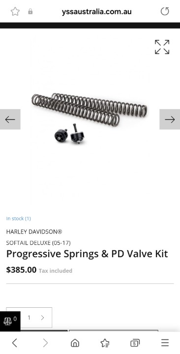

  • Steve L
    Steve L
    10 months
    Decided to give these a try instead of just upgrading the springs. They are a few weeks out as they have to come from the States.
  • Hilly
    Hilly
    10 months
    Quoting Steve L on 28 Apr 2025 02:09 AM
    I have a set of them in the shed, I ran them for a few years, this is just my take, plenty of happy campers out there, they handle bigger stuff really well, never had the front bottom out with them and I did hit some big stuff at times.
    What motivated me to change them apart from my seemingly endless urge to mess with shit was the small stuff, road chatter, I got tired of feeling everything when I was one up, 2 up it was better but still there, you can adjust spacers on them to help a little but for me it was not enough, this really is nit picking though as their improvement over stock is astounding, this is why I still have them as you never know......as I said before there are many people rapt with them and I hope you are one of them.
    If you fit a set of fxst tubes at the same time you will get a little more front end height, I found that to be a big plus, one of the reasons I want to change my dampers is to get that height back as well as mess with shit a bit more.
  • Steve L
    Steve L
    10 months
    Haha yes sounds like me, always changing stuff. I might run a 21"front wheel yet. If so that would definenetly give more height in the front.
