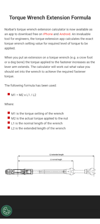

    FC, I'm a fitter and turner, worked most of my adult life as a diesel fitter or mechanic, I try not to tell people how to suck eggs because most already "know", you seem to want help so this pic is from Norbar, they know a thing or two about torque wrenchs, if your extension is 90° to the wrench use the same setting as what is called for, if it's inline as in the pic use this formula.

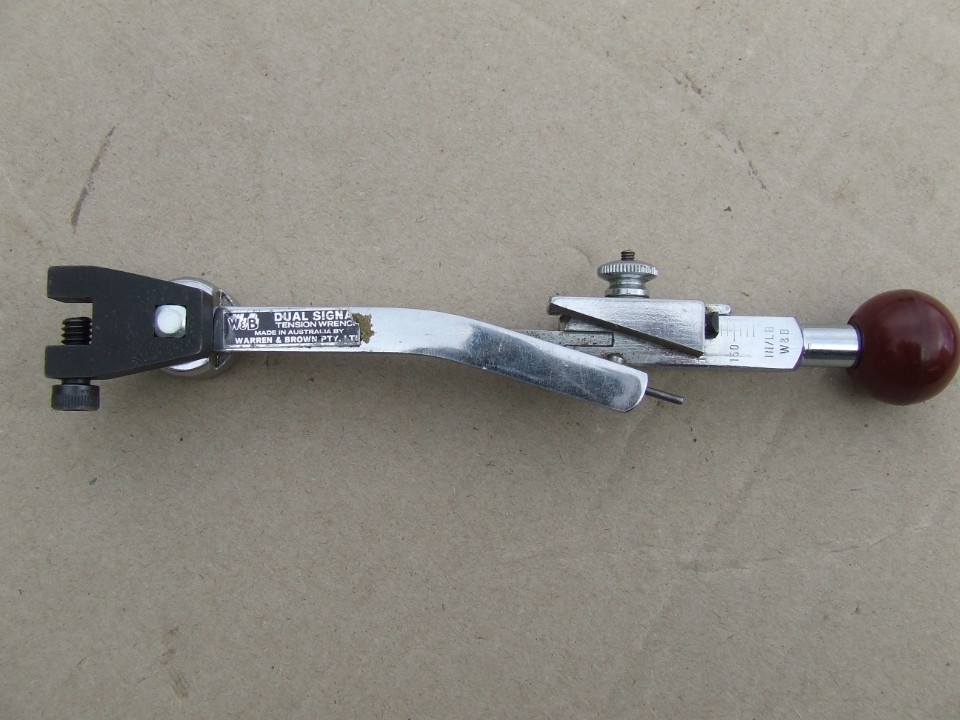

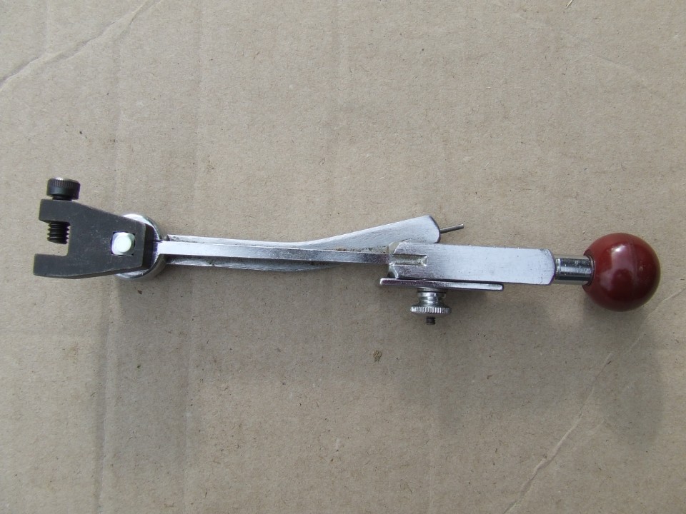

    Could you take a pic of how the extension attaches to the wrench FC ?
    I was thinking of it as a direct extension but it probably isn't.  If it connects to the square drive that would mean you now have two lever points  in the equation and that would complicate matters.

    Quoting beaglebasher on 09 Jun 2025 07:57 AM
    As you said before,  if the manufacturer has been in the business for a while you would think that they would know what they are doing.
    Pics are 7 posts back Beags.

    I can't see Hilly's post properly on the phone either, did you manage to apply the equation he supplied?
    Make sure you tell us how you go with it.
