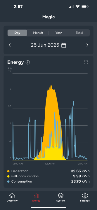

    Given current feed in tariffs you're better off using all the power you generate yourself, by whatever means you can, and don't let any escape.
    This is from a mates system in Brisbane, best imaging I've seen of combined useage and demand, my apps won't combine that.
    You can see his pool pump come on, the yellow rectangle, the demand spikes of various appliances and all the power still exported for fuck all.
    His next step is going to be a heat pump hot water unit programed to start from the time his export generally exceeds demand, and maybe then a battery.
    He has 20 years of experience living on off grid solar, but also years of managing CBD high rise buildings and refitting them to be more energy efficient, so he knows what he's talking about.
    I've also seen him rat through a couple of boxes of old truck shock absorber bushes at a workshop in Augathella and pick one to replace an aftermarket urethane front engine mount on his FXR that had broken up down the road.
    And I probably should add again that the low feed in tariffs are a result of the early retailer subsidised tarriffs coming to an end because they'd been so successful.
    Market economics, not a rort, increased supply means lower prices (unless you're Coles or Woolworths).
