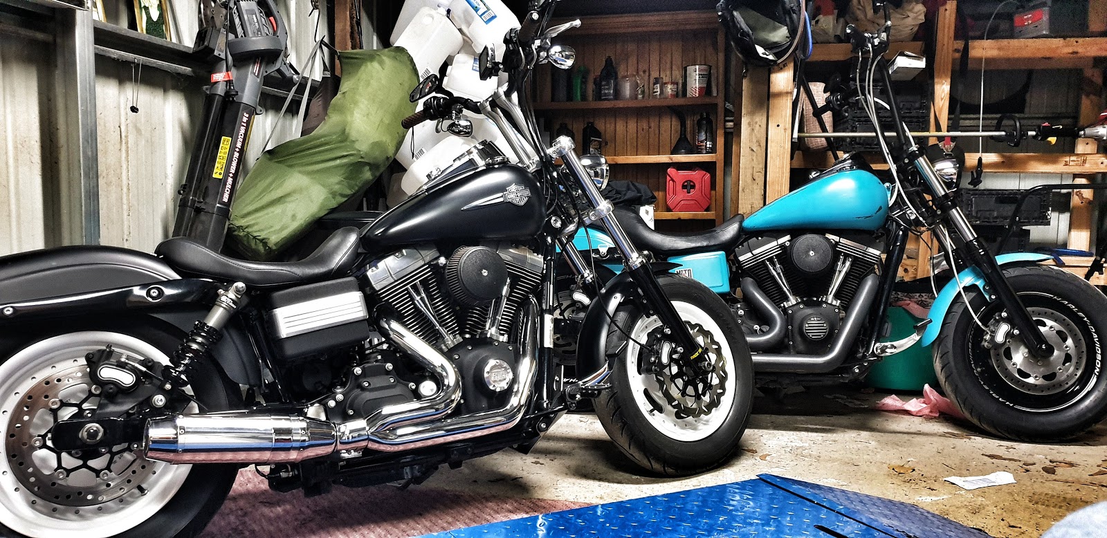

    I have big shots on my 2014 with a 103 and fuelpack
    I have D&D bobcat on my 2010 with a 96 and a Powervision
    The 103 makes its power down low to midrange but then runs out
    The 96 pulls harder than the 103 midrange to top end
    I suspect that additional back pressure will see you feeling more power off the line but not "up top"
    2:1 is best by a long shot

    Thanks and yeah it's a fair whack of coin. They will also be considerable quieter than your short shots.
    Another thing to consider with the big shots is they will scrape (one of many reasons for me getting the bobcat which kicks up)

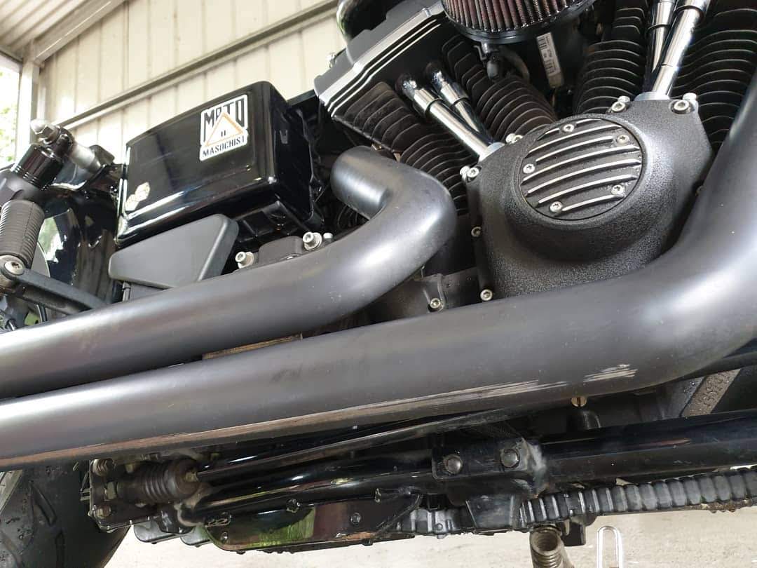

    I have 11.5 inch progressives on my 2014, this is from 6 months ago (it's much worse now).
    \My 2010 has 11" shocks with raised pegs and exhaust that kicks up and it'll touch a peg before the pipe (the way I like it)
