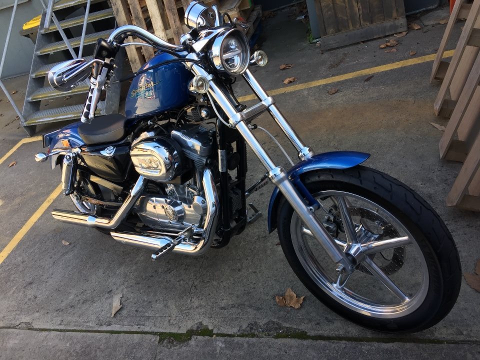

    Raked trees are the best way to make your bike harder to ride, ie bad Trail.

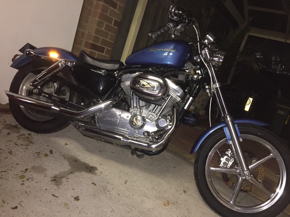

    I prefer rake cups instead of cutting the frame. “Vulcan Engineering (click on linked name) make cups sets for a few different models. I installed in my Sporty. (Not sure about yours.)
    3 degrees is not huge change, but I do get guys asking what I did. I know my bike is easier to ride, as I already run 4” overs.
    The cups (with own bearings) fit into the yoke in place of the original bearings.
    Effectively making the yoke slightly longer and 3 degrees more rake. The bottom cup has a fork stop.
    The kit comes with a new stem to put in your lower triple that has a notch for your steering lock.
    The system is extremely well made.
    Extending forks is highly recommended.

    3 degrees rake cups (4” overs)...
