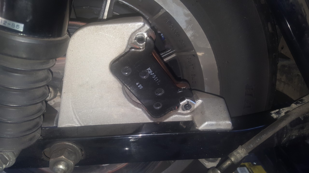

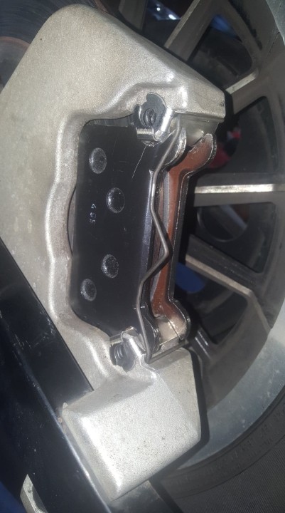

    Just finished putting a kit on the rear caliper, went to install but am having a hell of a time getting the pads to fit with the shims in place.
    Without the shims the pads drop into place as intended, with the shims placed in position the pads just don't want to fit easily.

    The first thing I would double check is ensure the pistons are fully retracted, sometimes they move out a little.

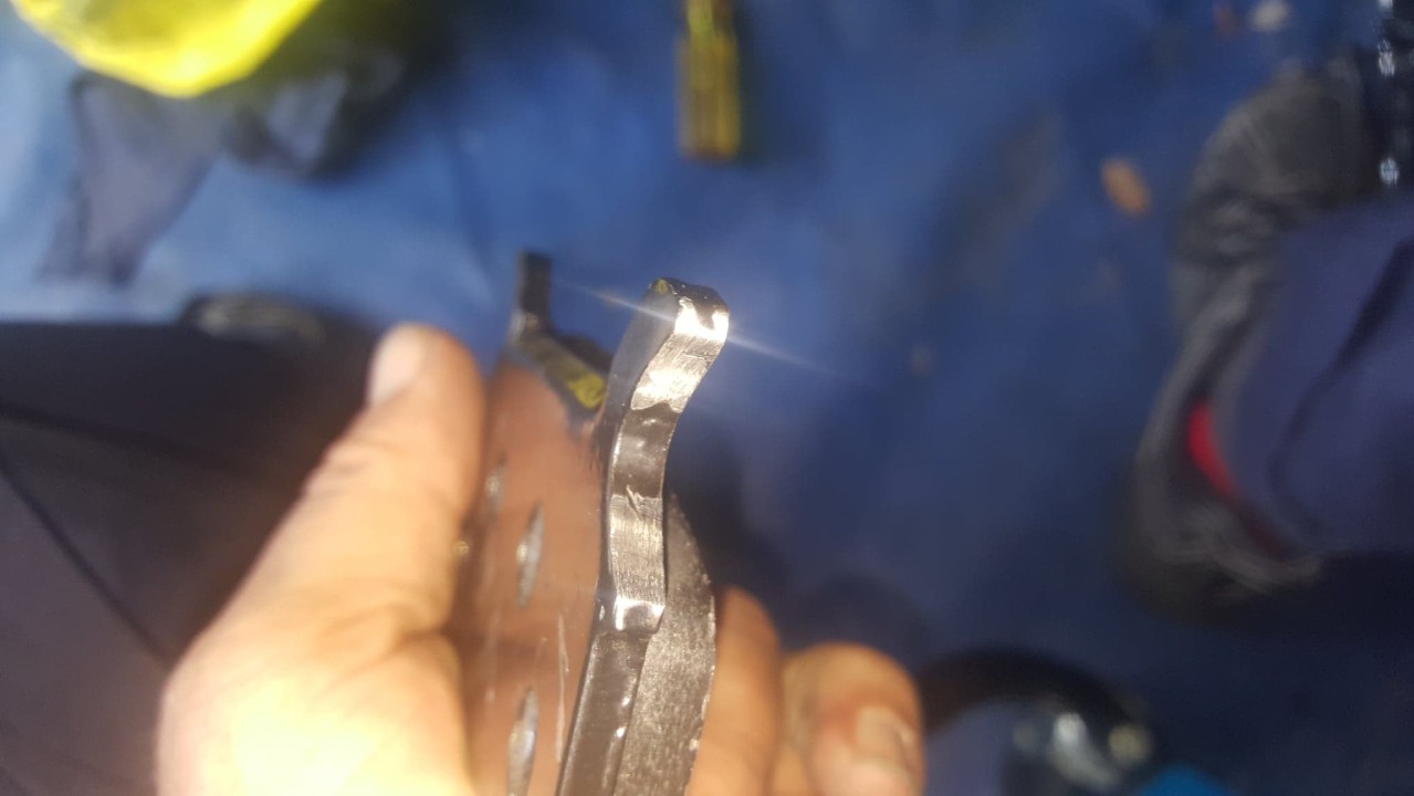

    No mate, the piston is not the issue. It's the overall dimensions (L & W) of the brake pad that is the issue. I checked the new pads with the old and the new ones are about 1mm bigger in width more so at the internal 'hooks', just enough to stop them going in as intended. That's what you get with aftermarket stuff I guess.
    I spoke with an old mate who used to have his own shop back in the day, he said to take a dremel and slowly shave off enough for the pad to fit.
    So taking a smidgen at a time I shaved them back and now they fit.

    Had to recently file a bit of some Performance Machine pads to get them to fit.
  • tussuck
    6 years ago
    Grind away, its not structural in that spot anyway.  Just due to various interpretations on 'tolerances' by some vendors I suppose.

    Yep trim to fit I guess.
  • perthhog
    perthhog
    6 years ago
    Yep have had to that myself

    Finished installing the new rear pads with a bit of gentle grinding.
    Brakes are working fine now.
