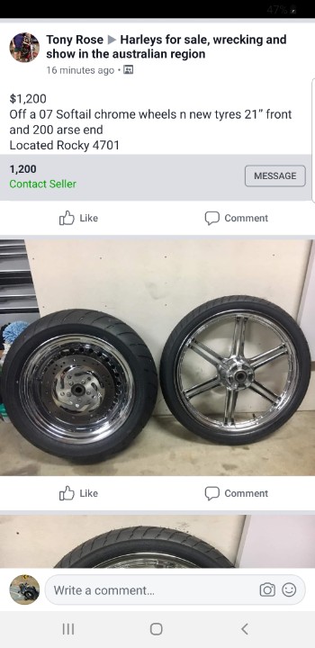

  • John.R
    John.R
    6 years ago
    This popped up today
  • HOG63
    HOG63
    6 years ago
    I’m in the process of putting a chrome Rocker C (5 spoke), on the front of my Sporty and a chrome Fatboy (slotted) on the rear.
    Would have loved to put the Rocker C rear on too but couldn’t be bothered with the wide swing arm guard conversion etc...
  • majorboot
    majorboot
    6 years ago
    Quoting John.R on 04 Jun 2019 06:37 AM
    Gotcha, thanks mate. I've contacted Led Sled in the states to see what we can come up with.

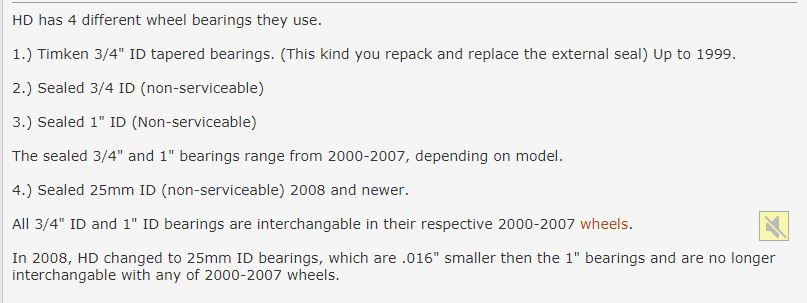

  • T4
    T4
    6 years ago
    Just for reference:
    Cheers, Will
  • John.R
    John.R
    6 years ago
    The only thing Ill add to that will, is that while 1in bearings all fit in 2000 to 2007 wheels, not all wheels can be use a 1in axle without mods. 00 to 03 or 04 wheels need to have material removed from the inner hub to fit a 1in axle size hub spacer.
    Only recently found that out..
