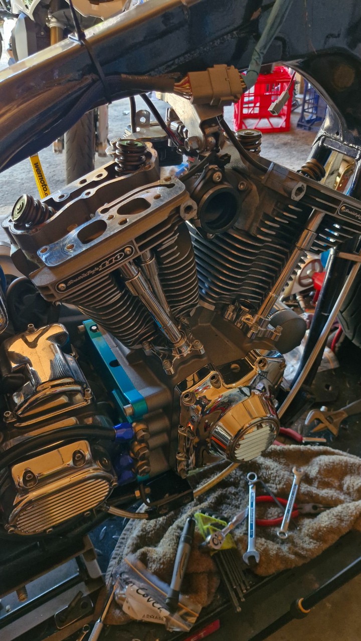

    7 years or so ago I had this bike built in my head, then 2 or so years to build it in reality.
    Its now being torn down and rebuilt, tweaking most things except the tins.
    New drivetrain setup, new geometry and suspension, handlebars, controls, brakes etc.
    Been slow going but have made some progress recently, pulling down motor to start the tweaks. Wanted to check runout before really committing to bits and pieces, and its come out nicely at around 3-4 thou.

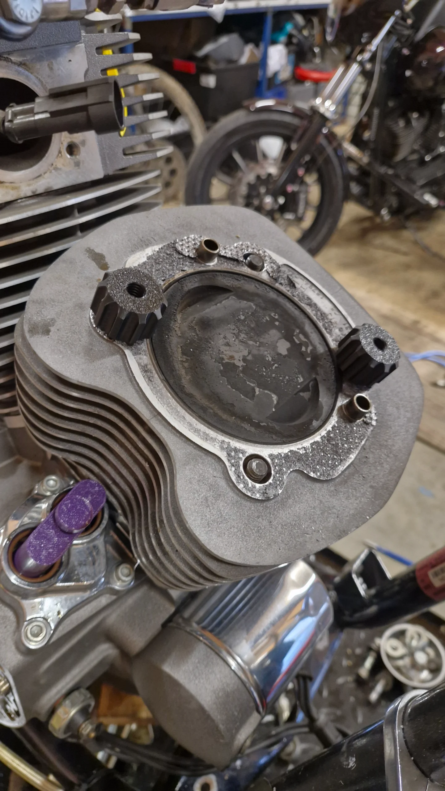

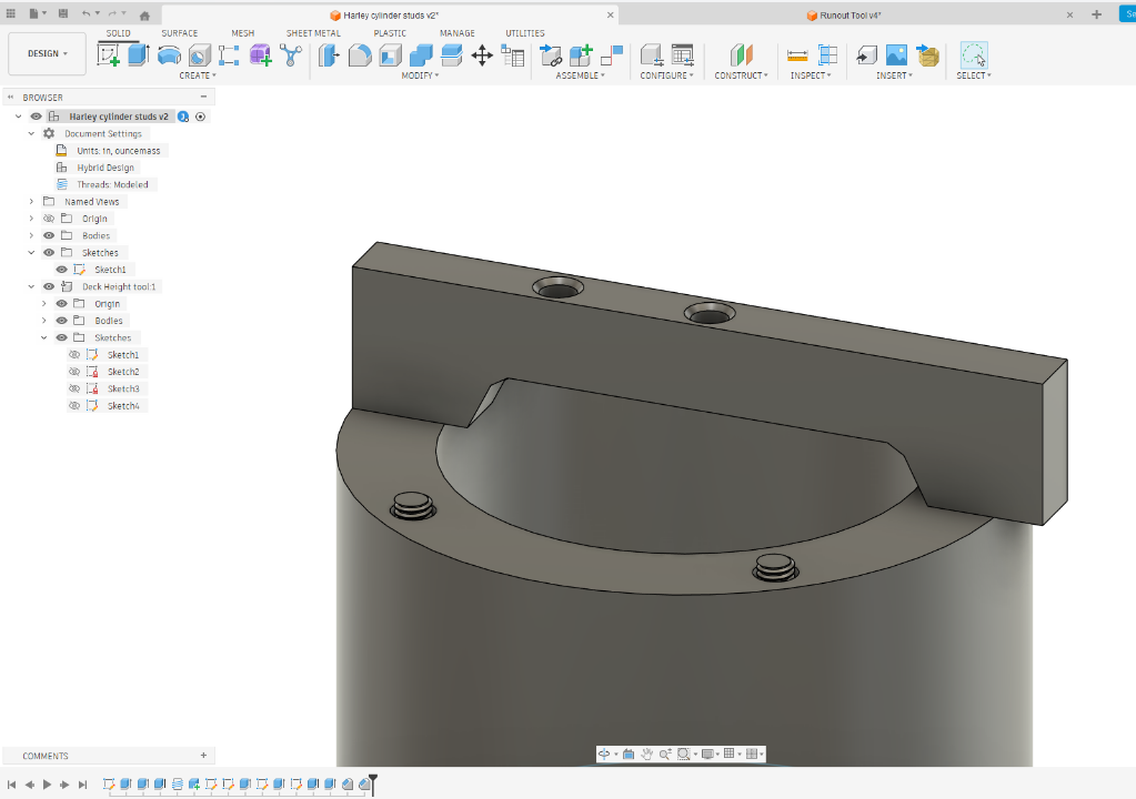

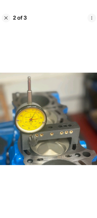

    Front head off, just printing a razor blade scraper to get the remaining head gasket off, then will see how i go with measuring deck height and whether I can get a measurement im happy with using a straight edge and feeler guages or if I print up a tool to use a dial indicator
  • Hilly
    Hilly
    12 days ago
    I see one of these in your future 😁

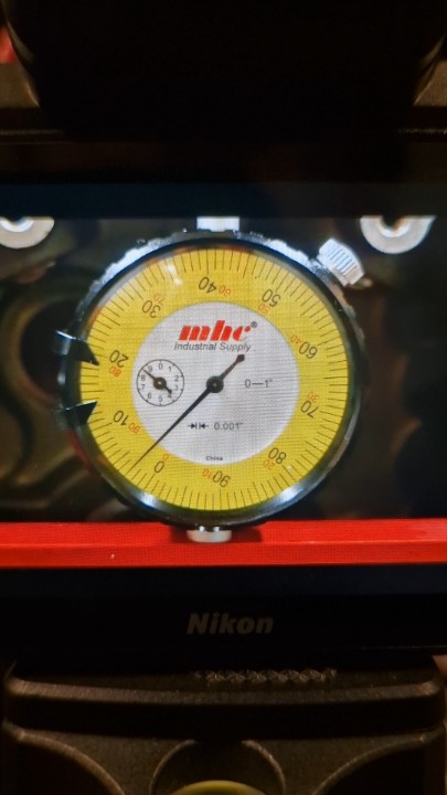

    Did some preliminary measuring last night, looking like 10-15 thou in the hole. Making a tool to both verify my measurements, and more easily take measurements from other areas of the cylinder to get an average. Its not rocket science in the end though.
