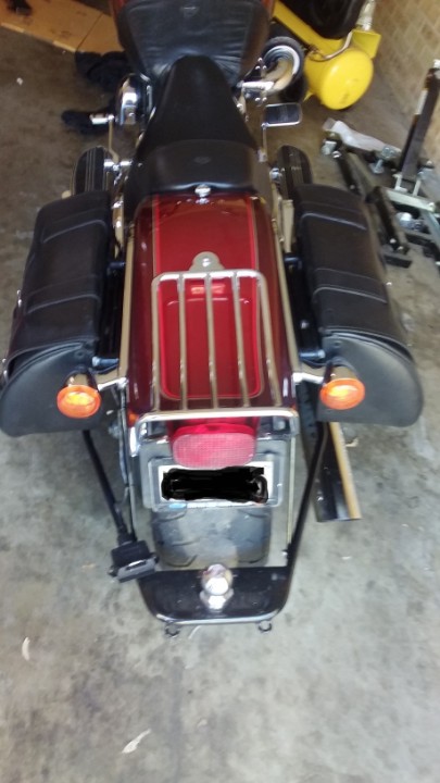

    Progress finally.
    Couldnt find a towbar for the 200mil rear wheel custom softail. Searched site after site for longer than an asian $5 love you long time girl.
    And heres Yandina Classic motorcycle trailers, (140 Kays away that make them) And I was told not possible on a 200mil  rear tyre custom softail.
