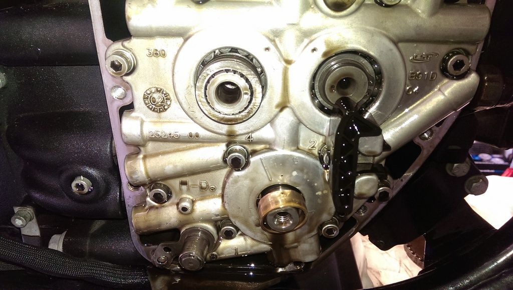

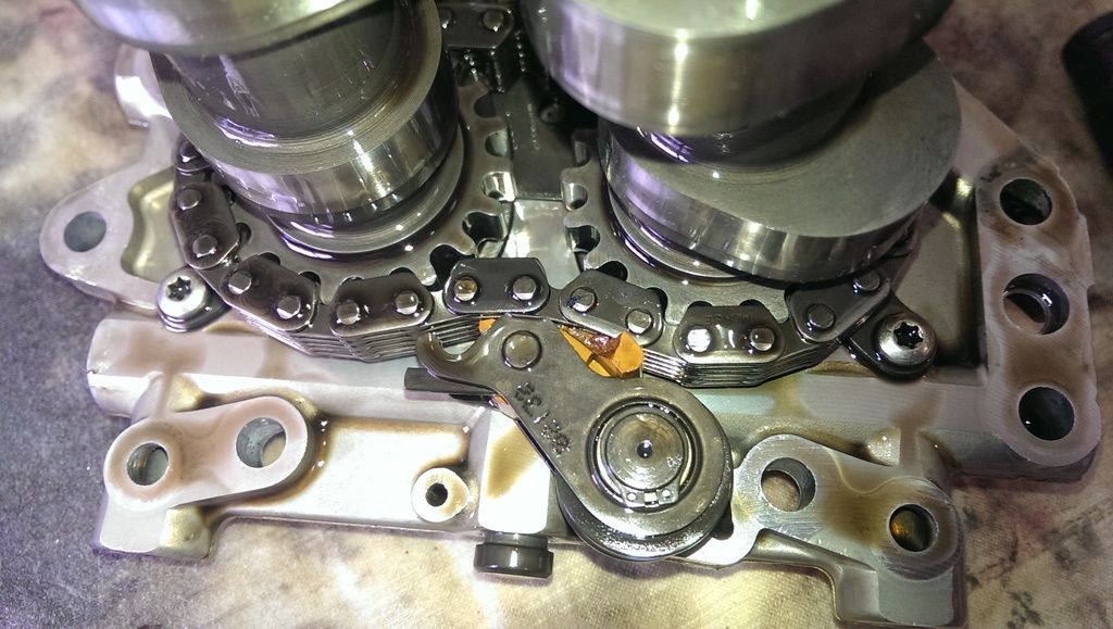

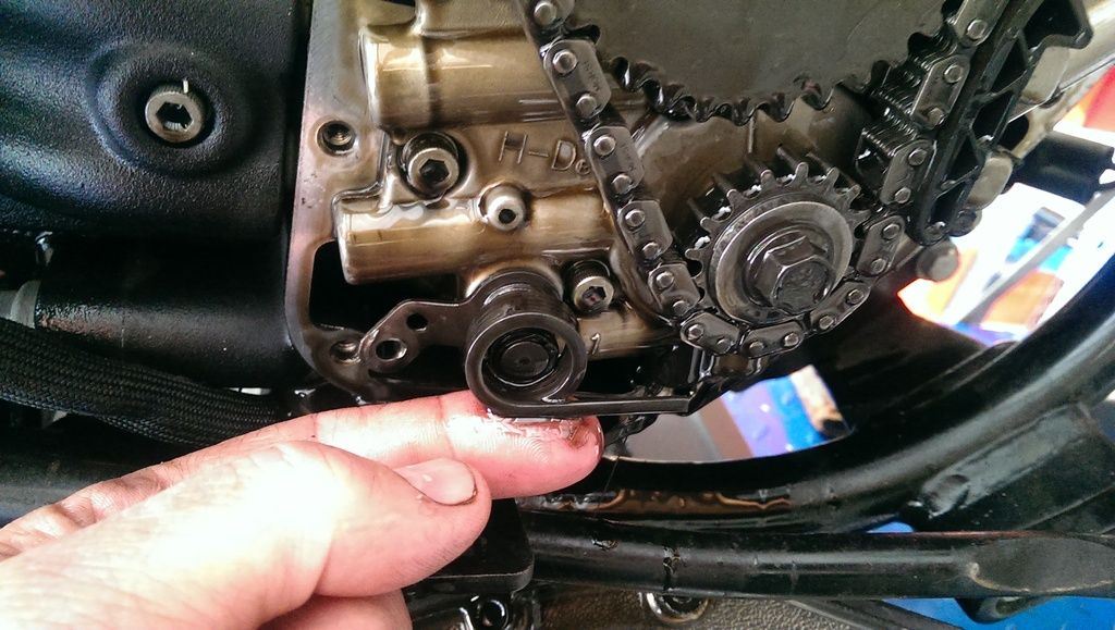

    So I tore into the cam chest and it is trashed, no cam chan tensioners left, can support plate bushing had fallen out and the cank run out is nearly 1mm.
    Sumping for sure the case was full and had just filled the motor up and had no where to go
    motor is out ready for a major

    Chains are Farked very stiff all over, even the crank has a tight spot with wear marks on the wheels from rubbing on the cases behind the inner cam bearings
