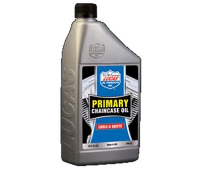

    9 years ago
    I use Lucas
  • Sugar
    Sugar
    9 years ago
    Was about to change to this next service, what do you mean by a bad run?
