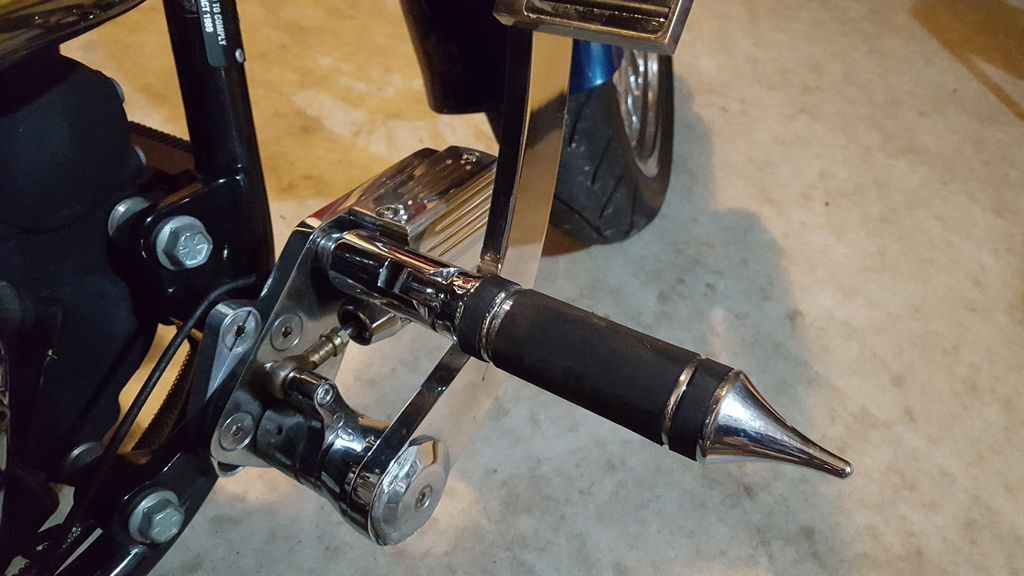

Rear Brake Master

    Been doing some research and another site has confirmed its most likely a DNA unit....
  • Vic
    Vic
    9 years ago
    Might just need a bleed BIGGIE?
    I'd be doing that 1st before buying the seal kit.
  • BIGGIE
    BIGGIE
    9 years ago
    thanks VIC, yes ill be doing that, but by the way it dropps pressure so quick I think something has failed in the unit
  • BIGGIE
    BIGGIE
    9 years ago
    I was under the impression DNA was US built and relatively high quality (going by their prices anyway)
    9 years ago
    nope
  • BIGGIE
    BIGGIE
    9 years ago
    good to know, sounds like the fix might be more expensive than I first though.....
  • BIGGIE
    BIGGIE
    9 years ago
    what do you think a reliable good quality unit will set me back? And is it a case of just replacing the internals but keeping the housing the same or is it a case of changing the whole unit?
  • BIGGIE
    BIGGIE
    9 years ago
    ok thanks for the advice.
  • BIGGIE
    BIGGIE
    9 years ago
    I decided to take the fatboy to a mechanic as the brakes were getting the better of me, long story short both front and rear masters need attention, previous owner has used dot4 instead of dot5 and caused damage internally :(
    Anyone know where I could buy a well price front and rear to suit what already existing on my bike? (without having to change controls etc)
