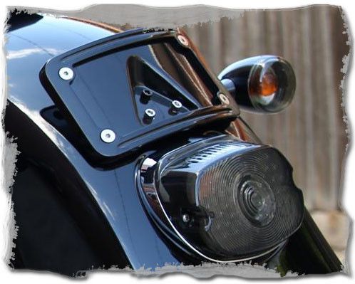

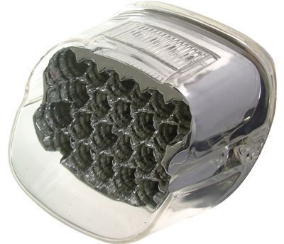

    If you never use a top box, I would take off the Chrome Rail Bracket then  Lower down the Tail light and Indicators 3 or 4 inches and fit a Lay down Rego Plate Holder above the Light to cover the hole left
    Maybe also  change the tail light to a lay down style aswell
