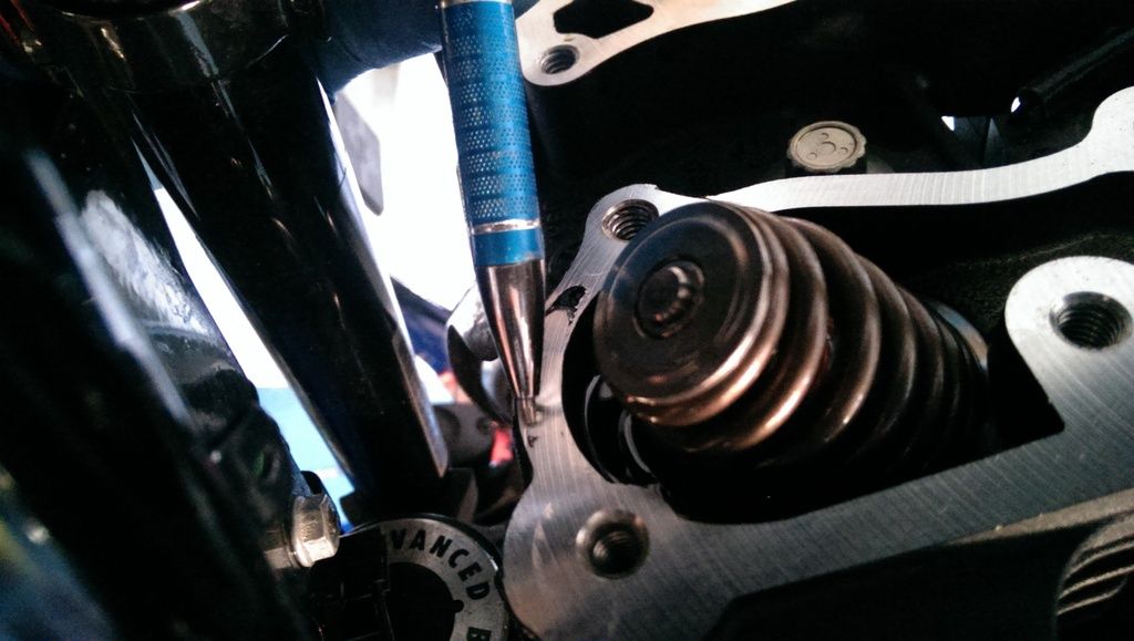

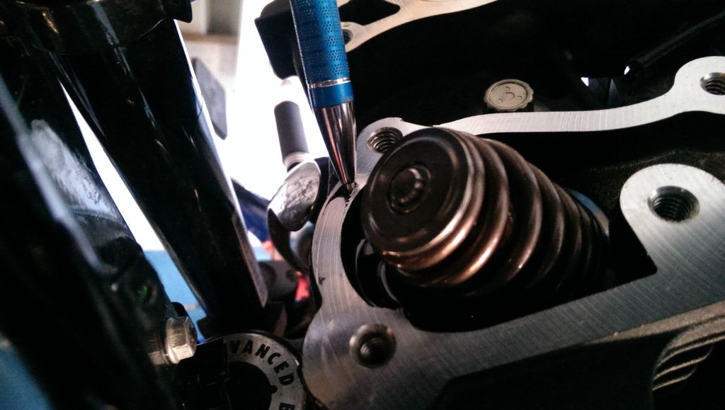

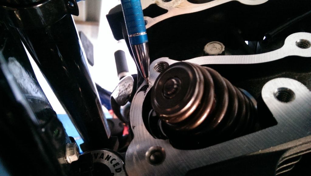

    Bloke comes to me with a 16 Model Breakout with 500ks on the clock wanting cams.
    So I pop heads fit .030" head gasket and cams take for a test ride all good, Customer picks bike up and rides into sunset.
    Next day I get a call that the bike is leaking oil from the front rocker box above exhaust, so I chuck on the trailer and go pick the bike up thinking never had a new lower or upper rocker gasket shit itself on me before.
    tell the customer I'll sort it and have it back to him in a day
    Now the juicy stuff I pop the front rocker gear and find a fault in the head casting and will now take this up with Harley for a new head, Customer is spewing that his new bike has this happen to it

    Sorry but just trying to confirm that it's a hole that the tip of the pen goes inside of?!
    Was the hole there when the heads were pulled for the change of head gasket and cams or perhaps not noticed? Can't believe it would of sealed at all from the get go...

    If he wants to ride it in the meantime why not just fill the flaws with JB Weld and level them off. Its not like its a high oil pressure or air zone given the breathers etc.
    At least that would get him up and running.

    mistakes like this shouldnt happen in this age of technology ,but they slip through some how occassionaly . had a not very old tractor recently that would not "breathe" and release trans pressure build up.removed pto housing and checked gallery drillings for the breather passages and 1 of 2 drillings had been missed in the machining process,easy fix, but should not have been missed.also surprised the head didnt show a leak earlier,may be the gasket just covered the fault and missed a bit when disturbed. i imagine the owner of a near new bike isnt that impressed.

    Difficult to tell from the photo... but could there have been a membrane of metal on the surface which would have resulted in your not seeing the issue when you replaced the gasket?
