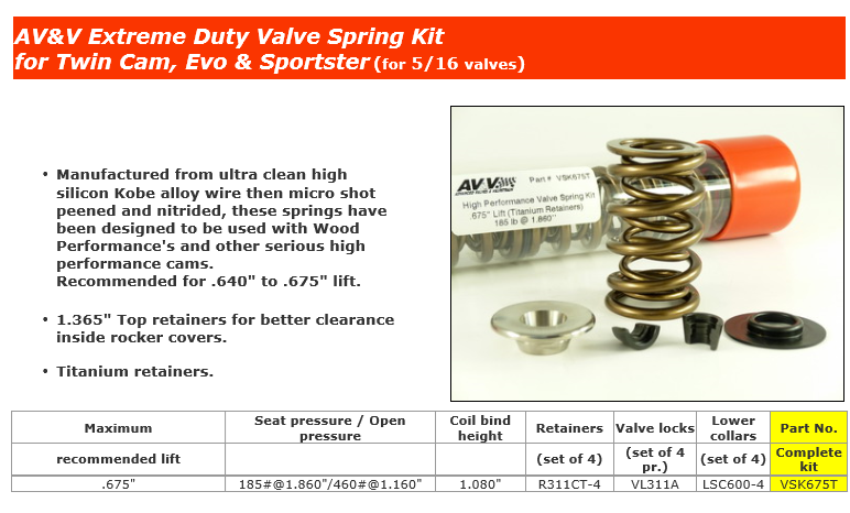

    Rollies supplied me with AV&V valves for my MVA Heads on my softail and now are suppling Frasers the springs for my Hurrican Heads
    These are the springs I have coming, come as a kit with seats and titanium retainers
    [URL=http://s307.photobucket.com/user/Ando1450/media/avampv_zpsyud8txoj.png.html][/URL]
