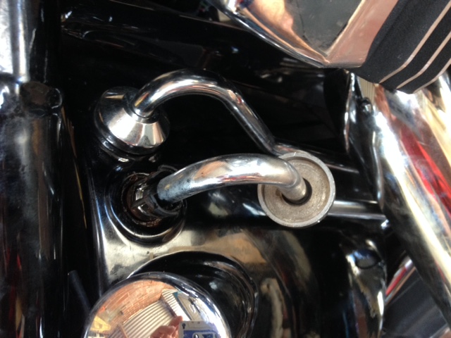

    I just done oil change on my FXST softail and thought I would try also evacuate the old oil from the sump via the return line. I had read that some people do this as it gets another liter of old oil out which would otherwise mix with the fresh new oil...anyway...I had read this is a good idea on the internet
    Pretty straight forward removing the oil return line and getting the old oil out but now I am having a bastard of a time trying to get the return line reconnected to the oil tank. WTF!
    There is bugger all room and I do not seem to be able to bend the line enough to make it 'connect' inside the oil tank.
    I am thinking will probably have to remove the whole exhaust from rear cyclinder to get enough clearance to do this...which will trun a 15 min job into a whole afternoon gone.
    Has anyone encountered this problem before and is there maybe something else I should try first?
    Would appreciate your suggestions!

    Slide the little cover up the oil line a bit,
    it looks like it is fouling on the tank, stopping the line from going in.
  • Renegade
    Renegade
    Haha, I wish it was that easy. It only looks to be touching on the photo but there is space between the cover and tank.
    The problem is the exhaust header does not give me enough 'wriggle room' to get the end of the oil line in at the correct angle for the entry hole of the oil tank.
    I was able to yank it out but now getting it back in is turning out to be a real bitch.
  • Gnoo
    Gnoo
    Yeah, mine can be a challenge at times,
    but as long as the cover is slid up and the o'rings not disturbed it will go back in,
    patience and persistence will get you home.
  • Renegade
    Renegade
    Wise words and proved true!
    Thank you Gnoo for your help.

    Getting the return oil line out is easy with the tool. It's called a fuel line disconnect tool and is only a few bucks from Repco/Supacheap.
    Size you need is 3/8.
    Getting it back in was a lot more difficult than I expected.
    Whilst I got a fair bit of old oil out, I am not sure it is worth the hassle. I will probably just stick to the Harley recommended oil change intervals from now on.

    I scavenge on all changes and believe it's a good thing to do and it's a piece of piss after done once.
    Had problems getting mine in the first time i changed as previous owner had replaced O ring but not taken old ones out.. After a bit of frustration ended up finding 2 or 3 old O rings in tank where lines go in preventing it from going in.
    Unlikely for you but worth a look.
