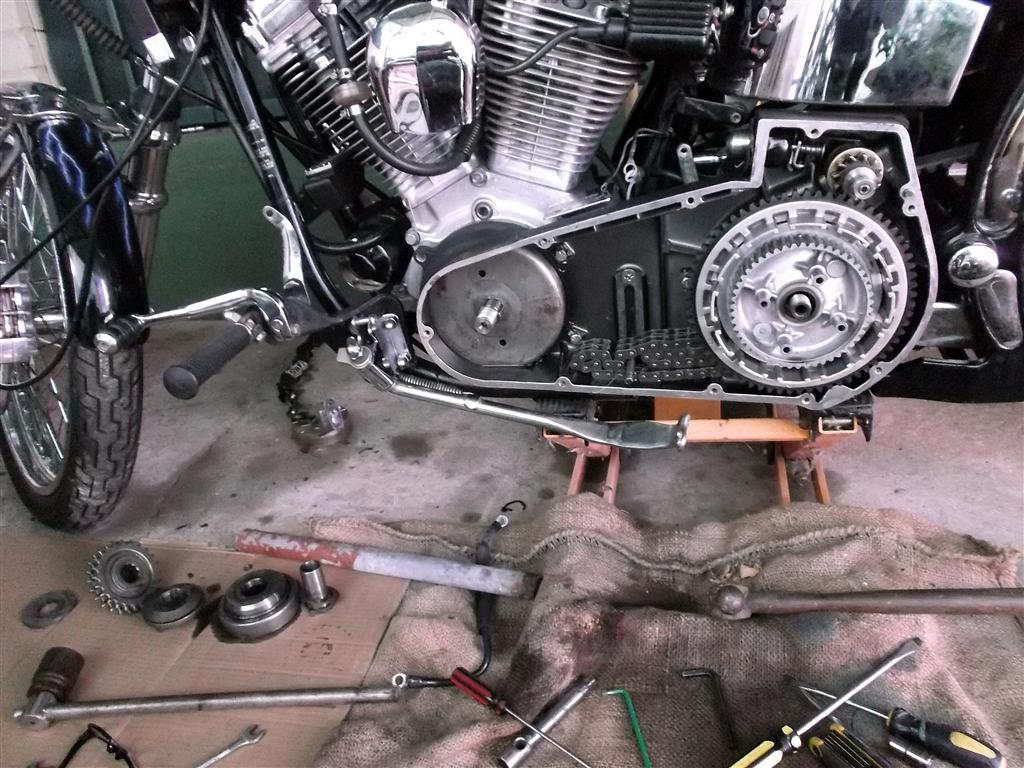

    g'day all,does anyone know if any of the auto shop pullers can adapt to to work on an evo clutch, thanks.
  • perthhog
    perthhog
    If it's a early one there on a tapered shaft, if it is a late one its on spline and normally just slide off
    But if it's a bit stuck two large screwdrivers behind it with care off corse but other wise yes you should be
    Able to use a large 3 leg Puller and yes the clutch hub nut is left hand thread
  • bobby bob
    bobby bob
    thanks perthhog,yes it's early,87, I found my jam bar but could not find the puller that a mate made up for me 25 years ago when I rebuilt a 79 fxef 3 bolt clutch so am unsure about using cheep auto puller on 4 bolt clutch, I will see if I can move it with srewdrivers, I have to install a new charging kit. Righty loosey as the yanks say, lol.

    Are you a tapered or splined shaft? Mine is tapered and there is no way you would remove the Clutch without a hub puller and a hammer!.

    I was referring to a spline shaft type to pop off with screw drivers which I've done many times on different Appalachians but with the tapered type
    You will need a puller of some type not sure if would pull from those small bolt holes though ,but in saying that the jims puller is like that and yes starter/jack shaft need to come off As for the dremal trick that can apparently be done to Tc primary's have heard of being done on this forum

    The best way to remove the hub once you have the puller is to fit it and preload the puller with a fair amount of force (I mean heaps). If the hub does not just pop off then get a hammer and give the puller main bolt a 'love tap'. 90% of the time the hub will just pop right off after the first couple of taps. Just be careful to not beat the heck out of it as you could damage the trapdoor bearings as they are whats on the far end of that shaft! Also make sure you do not overlook or loose the small taper key.

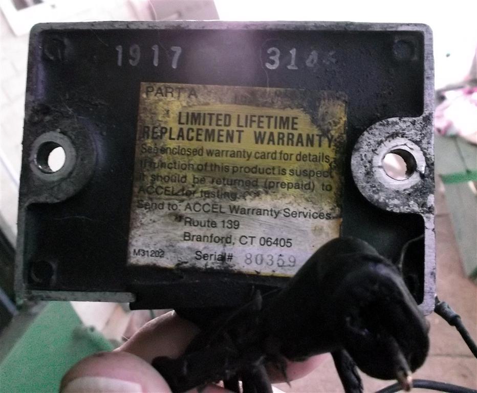

    the plug into the engine case has perished an oil was pissing out, is this plug a separate item from the stator?

    yes that's the one , stator plug, fell apart, also the 2 pin rectifier plug, don't know how long these had been on, bought this bike 3 years ago.

    pulled starter motor out and the housing was easy, the hard to get 1/2" bolt I cracked with socket and flexi, then got my fingers in too easily, I thought, fuck, why do American books make thing sound so complicated' to me anyway, thanks guys.
