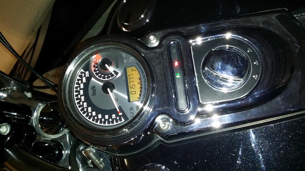

    Just want to make sure I and looking in the right direction.
    I have a 2013 Fat Bob and have just lost the left indicator and high beam lights on the dash. Green arrow and blue light.
    Indicators and high and low beam work fine. Codes I get are a B1101, which is for a blown L indicator light.

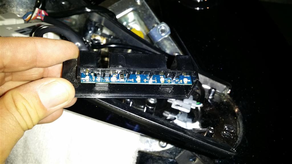

    Took it all apart and cant see any obvious damage or burnt wires etc.
    Is it the circuit board or should I be looking somewhere else?
  • speedzter
    speedzter
    Buy a cheap multimeter and measure the LED's, or your local auto elec' should be able to check it in less than 5 minutes.
    If they measure OK, work your way back.
    If there is a connector mounted on the board, check for dry joints.

    Rapson, I lost my left indicator dash light 2 weeks ago. Yeh no burnt wires etc or tell tales. I just Bought a new panel $57. 2 minutes to change.

    Guys I just rang and ordered part from local dealer, they got it in a couple days. My part number may be different from yours. You must replace the Whole LED unit. plugs in. takes 2 minutes.

    just checked, my part number is 69029-11                         Mine looks identical to your pic Rapson,
    Lamp Assembly, LED Indicator ( stamped on label)

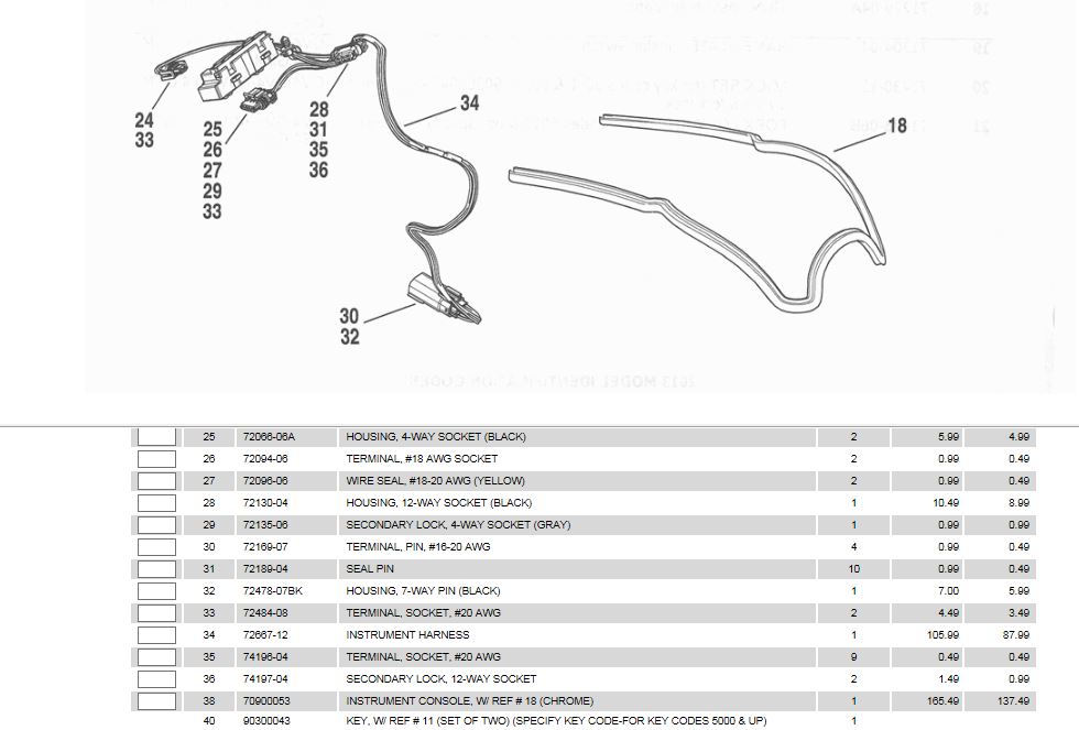

    By the looks of this the price I have is for the whole harness. I have shot Harley Heaven an email to, thanks!

    So i finally got around to installing my $139 LED panel i ordered from Harley and it doesn't work!! All i get is the N light, which also stays on when i turn the bike off!
    Put my old harness back in and all works, except for broken LEDs.
    So do i have a dodgy harness and should go back for another one or do i have a different problem?

    Update. My bad... Took the harness back to Gasoline Alley. Took it out the back and hooked it up to another Fat Bob and it worked fine. So I have a yarn to the mechanic and it turns out one of the plugs can go in backwards. Its on the back of the speedo so you cant see into it to identify the lugs. Took the harness home and installed it correctly and hey presto, it works! Many thanks to the guys at Gasoline Alley, Burger and Dan for helping me out.
