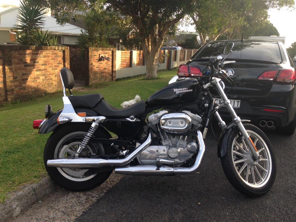

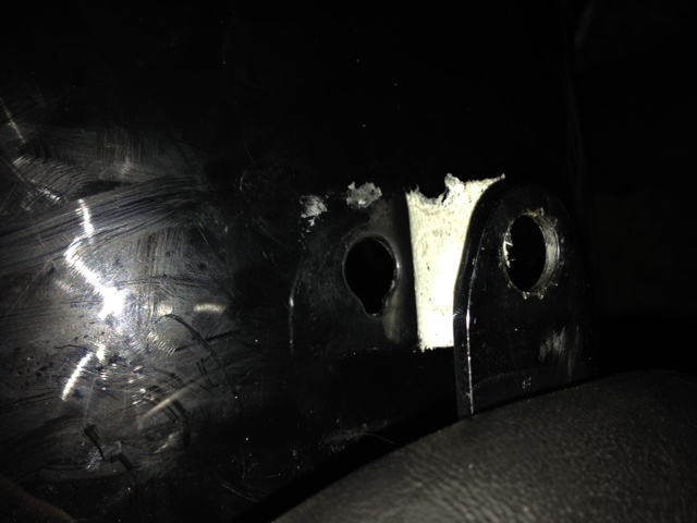

    tried to remove the passenger back rest and seat and when i did, the screw to secure the single seat is missing (just a hole there) is this normal? how do i secure the single seat to the bike?
    also another issue i have been having, the oil cap seems to be in a very strange position, pretty much every time i sit on the bike the oil cap hits the inside of my leg and raises from the down position. does anyone else get this? is there any way to fix it?

    oil cap popped up.
    screw to secure passenger seat
    no screw to secure single seat

    on the bottom pic the hole to the right is the one on the seat, the one to the left is the one on the bike that the seat should screw into

    remove the plastic sir clip washer from the fender nut in the first pic and put it in the hole on the second pic
    ther ya go ,simple fix that one
    i you wanna keep one in the rear hole so you dont have to keep swaping if your gunna use pillion seat sometimes the stealerships sell em for about 4 or 6 bucks i think it was (fender seat nut theyre called)

    you could try another oil cap, maybe a lower profile one off a softail may fit (it may not) im not familiar with your model or vintage
    someone here will know
  • jinda
    jinda
    When correctly fitted, the cap should sit flush to the tin after it is pushed down.
  • FXST11
    FXST11
    If i remember correctly, On my sporty when I had it. You push the Oil filler cap down and it will make a click sound to hold in, Then to get out again. Push, another click sound and it raises.

    with the oil cap, it is flush with the chamber, but when i sit on the bike the inside of my leg touches it and is enough pressure for it to pop back up. is it possible to get one that locks? or has a different open/close mechanism?

    hey ben, if its a quick release seat hardware "KIT" it should come complete with all the components
    when you buy a fender seat nut from the dealer it comes with the fender nut and plastic clip and also an aluminium knurled screw with a flat head screwdriver slot in it
    I would assume that's a quick release kit cause you can loosen and tighten it with your fingers, I use a stainless washer and a nylon washer above (beneath the knurled screw) to stop binding/scratching and I always nip it up with a driver to be sure (stops the seat being easily removed by hand if some low life wants your seat)

    Mate, once you remove the circlip the seat nut that protrudes through the fender will fall out. To help you get this back back into the new hole, slide a zip tie through it and then feed that up from underneath through the hole and pull it into place. You can pull on the zip tie and that'll hold it in place to get the circlip back on. I couldn't get my fat hand up there when I changed mine over and this sorted it.

    Thanks for the replys everyone, managed to relocate the rear screw to the forward one with no issues. Will order another as well as the quick release kit and see how that goes.
    Also managed to sort the fuel cap issue with a bit of a fiddle.
