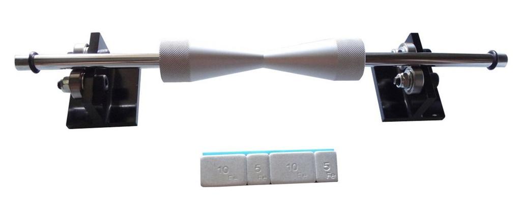

    I made a stand with adjustable legs and bought the shaft and cones online for about $40 the whole shaft rotates on 4 roller bearings attached to some plates wich run on the outer ends of the shaft. So the wheels bearings don't do anything but support the wheel.

    I just made the two bearing supports similar to the picture above that fit to a set of car axle stands.
    Remove any rubber seals from support bearings, clean the grease out and lubricate with some light oil.
    Just fit the axle back in the wheel, and sit it on the bearings.
    No need for any special cones, etc'.

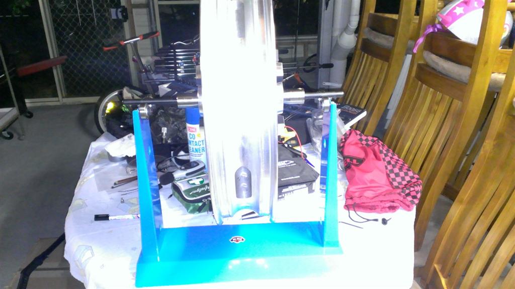

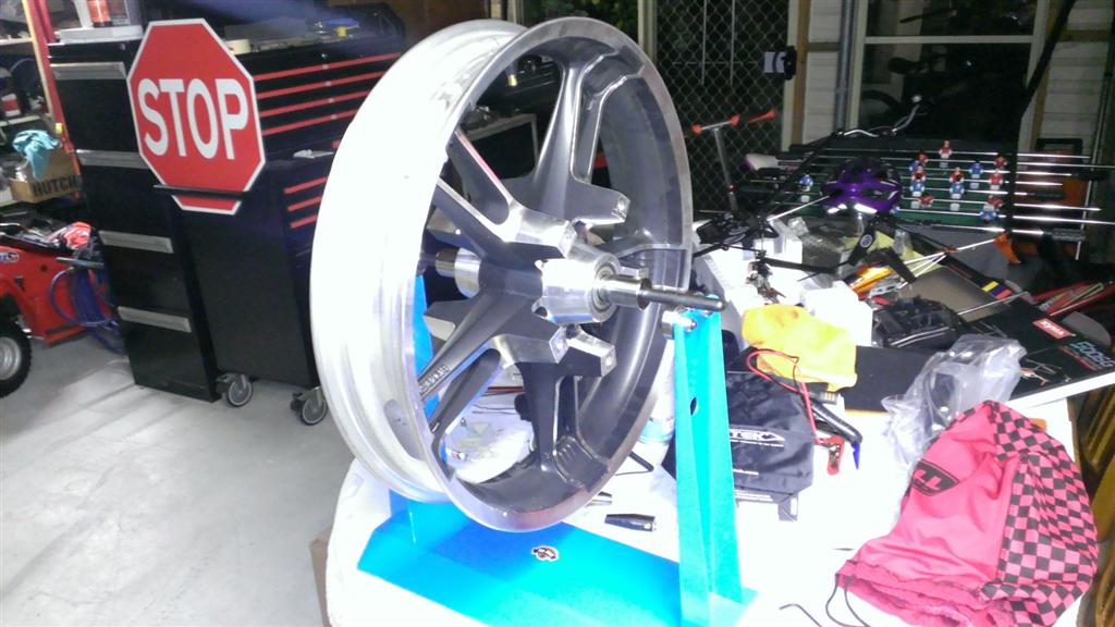

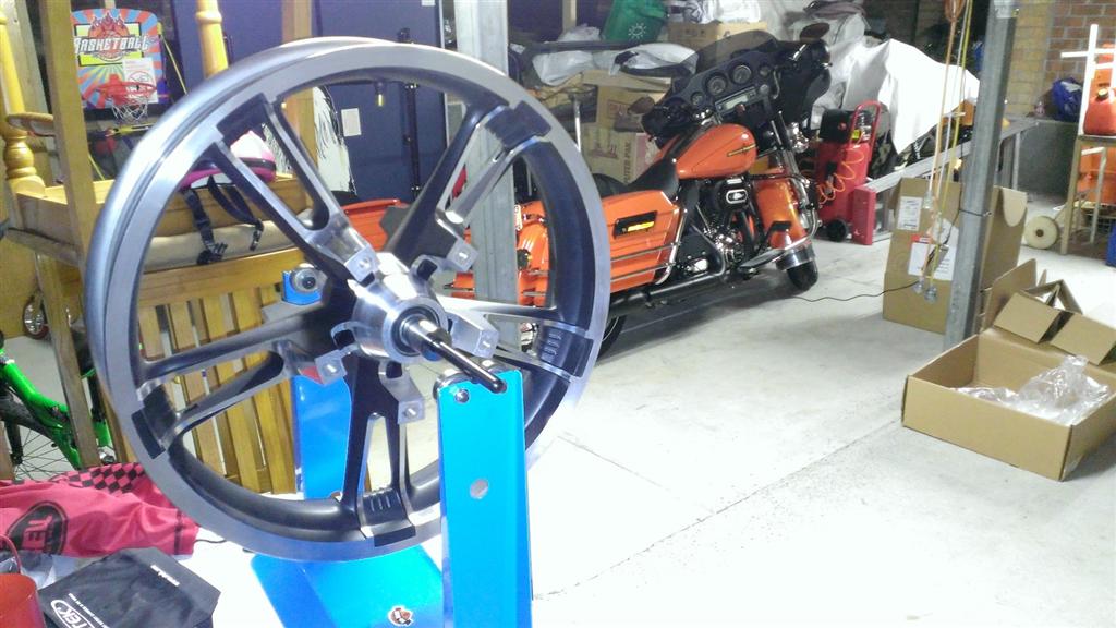

    I actually just bought one a couple of weeks ago. I  started making one but when added up cost and my time, not worth it.  New one below.
    One thing i have found out is there is a green dot inside the rim and that turned out to be the light spot on the rims.
    Apparently there is a dot on Some new tyres and that is supposedly the light spot on the tyres also. So when i put mine on I will match up the light spot of the tyres on to heavy point on the wheel and balance as neccesary from there.
    Some say that you put the dot on the tryes next to the valve on the wheels but not in all cases. As you can see the valve on this rim is just off the top centreline.
