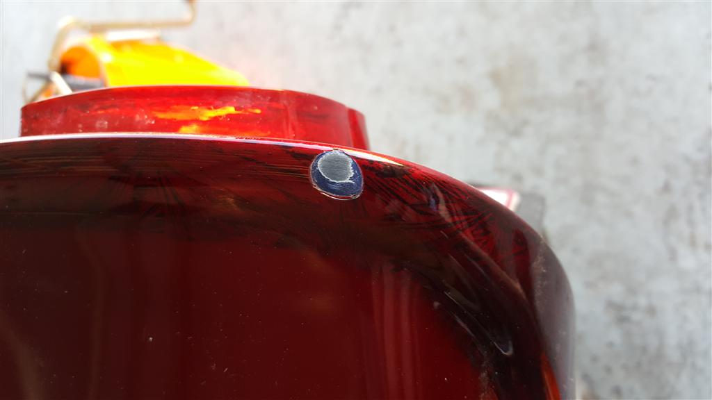

    But first have deal deal with the assclowns at the bike shop again. Only noticed after getting home that there is a massive chip out of paintwork of rear fender. About the size of a10 cent piece. Gone through top coat, old paint and down to bare material of fender. Not sure how it's happened (looks like it's been hit with a grinder!). You couldn't of done it without knowing you had hit the bike. Haven't been able to get in contact with manager yet. Sent email on Saturday when I found the damage but still no word. I'm pissed off big time. Not a easy fix as its on custom paintwork, that I can't see being matched....

    I'm with Retroman on the tuner gig, as to your paint damage "fark"
