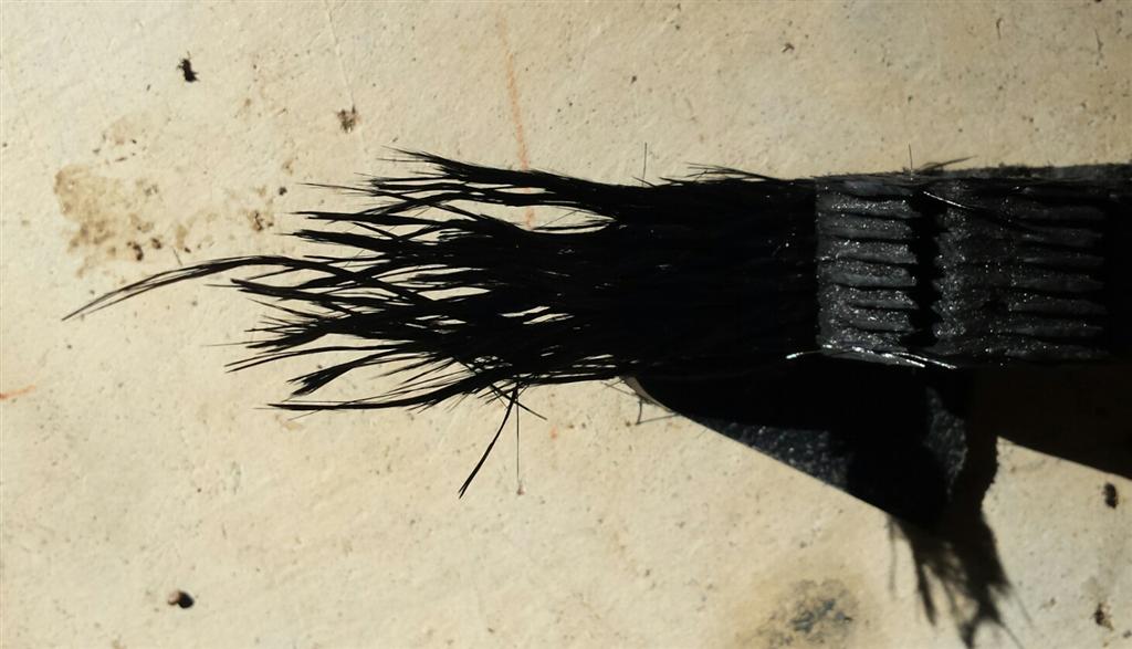

    Hey guys just wanted to post the pics of the belt that let go on me ... bit slow to post , been to busy moving and trying to get some rides in .
