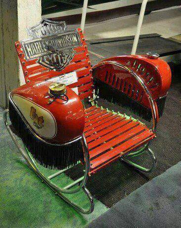

    Put in a column/pole mounted swing out jib to put your block and tackle on so that you can lift heavy items like engines, machinery out of a trailer etc.
    They take up no space and are super handy.
    You also need a comfortable Chair.
    Something like this one perhaps?
