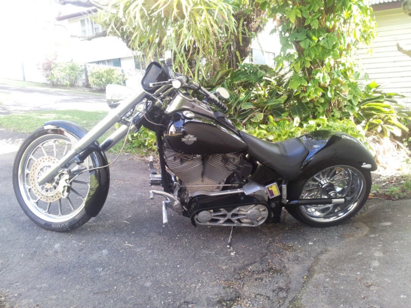

    I've got a mate that's looking into purchasing this bike from QLD but being a custom bike I'm thinking he might have some problems getting it registered in NSW. Does anyone have past experience or knowledge about what's involved in getting it registered in NSW?
    Here's a list of the good bits on the bike as advertised.
    Genuine harley davidson frame
    124cc twin cam s&s motor with diamond cut heads and barrels
    baker 6 speed gear box RSD
    BDL 3" belt drive primary
    300mm rear tyre
    63mm inverted meanstreet frontend
    fournales suspension
    custom cycles controls
    burleigh bars
    6 gallon stretch tanks
    headwinds head light
  • fatbat
    fatbat
    There are two obstacles:
    1) the roadworthy process; and
    2) the id inspection
    It doesn't appear to be roadworthy or compliant with ADRs. Getting somebody to roadworthy it will therefore be difficult but possible depending on who you know.
    But the id inspection will be with nsw roads and they will notice the obvious roadworthy issues with the bike. This will then cause problems for the issuer of the rwc.
    If some of those mods have been endorsed by an engineer as being ADR compliant, that's a step in the right direction but you'll find nsw roads will not recognise the qld engineer's report so it'd need to be re examined by a nsw engineer.
    Good luck. Your mate will probably need it.

    Interesting bike. Even in Qld you have to have heavy modifications blue plated (engineering modification plate) and looking at that I can see obvious things that should not even pass engineering in Qld.
  • chriso
    chriso
    Gezz he's got a world of problems coming up mate, fatbat has nailed it
    The Bike dosn't look that bad, if it passes a RWC, he should be fine
