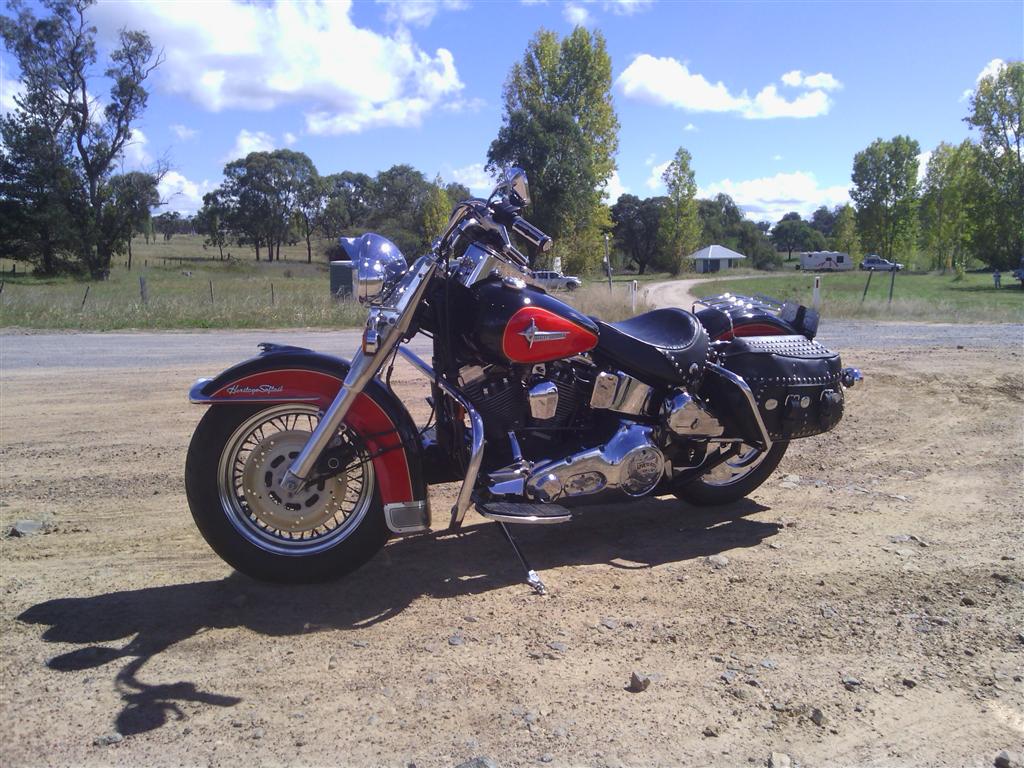

    I want to put a 19" or 21" wheel on the Heritage, thought I'd get a good used one from another bike. I want to use the ome guard and brakes.
    Does any body know what wheels will bolt straight into the front of a 1992 heritage?  Superglide, Sportster?
     Does a 21" fit under the guard as is? Does a standard softail fit up?
    Any info is wellcome.
    Doug
    Ps This where I'm up to on a tight buget...

    Guess this has been done to death, I'm not real good at finding things on PC's. But I've found out a bit. Thanks.
  • Captain Hook
    Captain Hook
    Do a search on google for a tyre diameter calculator. Most of the 16 to 19 Harley wheels have about the same rolling diameter, so they can be swapped, check the axle size. 21's are bigger and the guard might not fit anymore. Had a 21 front and swapped for a 16, it handles better now.
