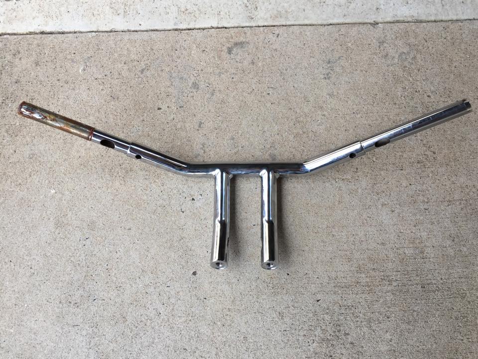

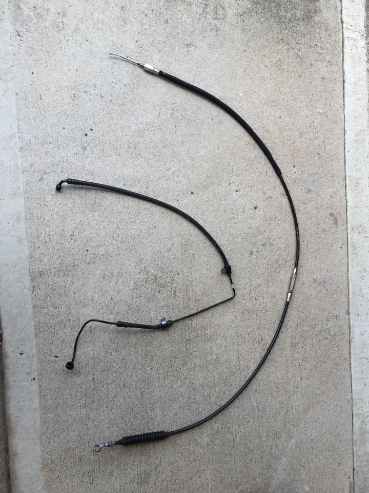

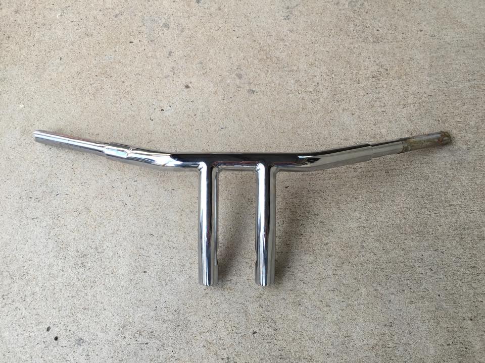

    A guy is selling some 1 1/4 inch Street Slammer bars with an in built 7 inch riser.  I have an 07 fatboy with standard bars and was wondering if I will need to change any cables? He is including a clutch cable as well.   I know its a common question but a search here revealed no answer for me.  The way the stock bars curve around play hell with my right hand that has a plate in it from a get off years ago.  I was thinking because these are a bit straighter they may help with that.  Dont really want to outlay for cables etc. at the moment.  Any info is appreciated.  I would imagine they are not too hard to fit either.? thanks.
    Heres some pics

    you will be right mate with stock cables, I fitted Burley roller bars to Fatty low and had no issues

    Should be all good using the same cables.
    Not too many like the angle of the 07 Fatboy bars.
    Will need to remove the tank to r & r the electric control cables.
