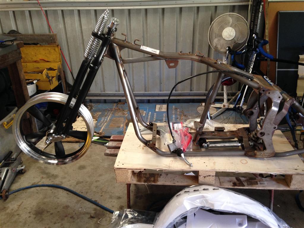

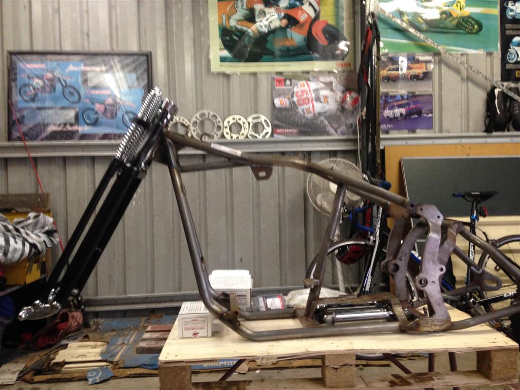

        After being flooded in  for the last 48 hours with category 2 cyclone winds  i got in the trusty hilux  got through the water and made to the courier depot to pick up the softail frame / springer front end that walka sent me up from VPW .
         Will post some photos up soon and will be after  advice on the bulding of this bike anyway thanks Walka for getting it up to me and the advice already

     roughly set up a bench . ready to go

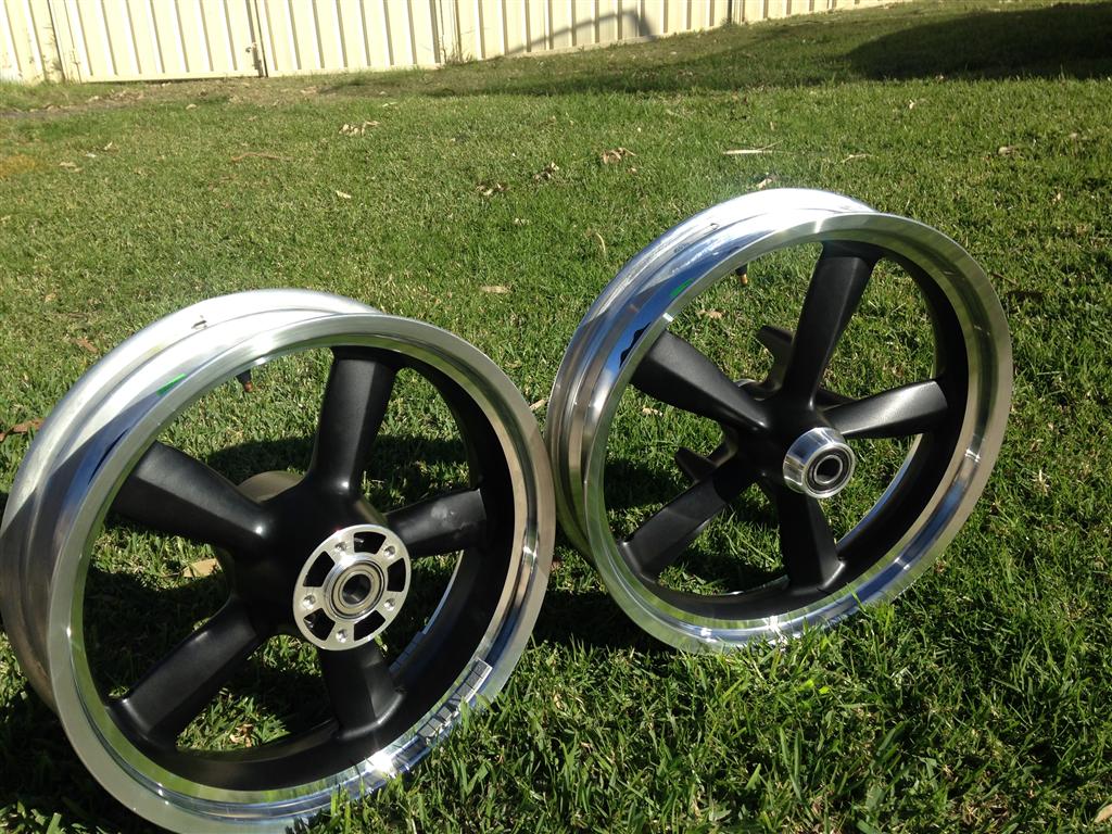

    Heres the wheels . they are off a 2015 dyna switchback the  woman who bought the bike went the chrome option wheels she onl y picked her bike up a week ago these havent even been used ! good ol fleabay
    That's going to look hot
  • hdbloke
    hdbloke
    got to be honest with you Walka , i sort of had an idea of what sort of bike to build in my head but with every part it seems to change and after getting these wheels i think the level of quality i had  in my head has just had the bar risen ......HIGH
    That's how it go's with every Bike I've built , and you know it's not that hard .. this one is looking very exciting

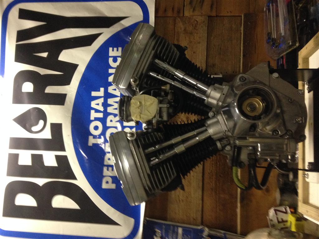

    Motor arrived today
    thanks Noah for your help and doing buisness with you , next thefuel tank
  • perthhog
    perthhog
    Good stuff you might have to tap the engine case at the front to mount the oil filter mount As that looks like a early evo which the oil filter mount , mounts to the frame
    And the kraftech frame hasn't got the mount.( It's a option ). So you will have to convert to the later style
    Thats why God made Remote Oil Filters
