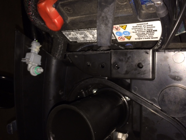

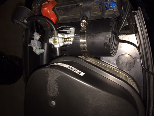

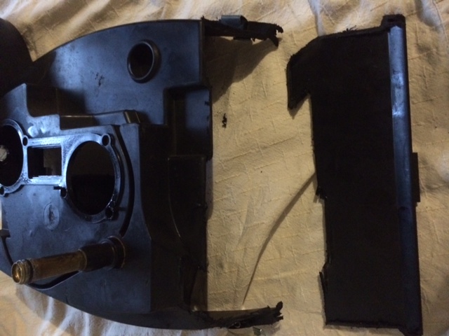

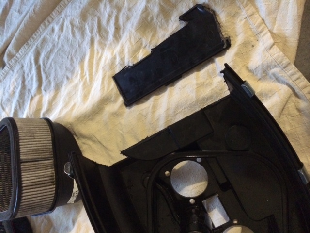

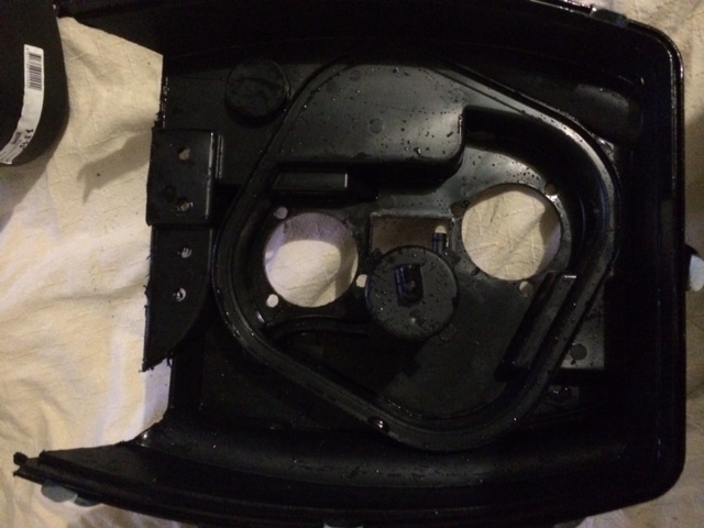

    i cut the front off the airbox, leaving as much of the bottom as i could. I was doing this mod for the compressor install after all...

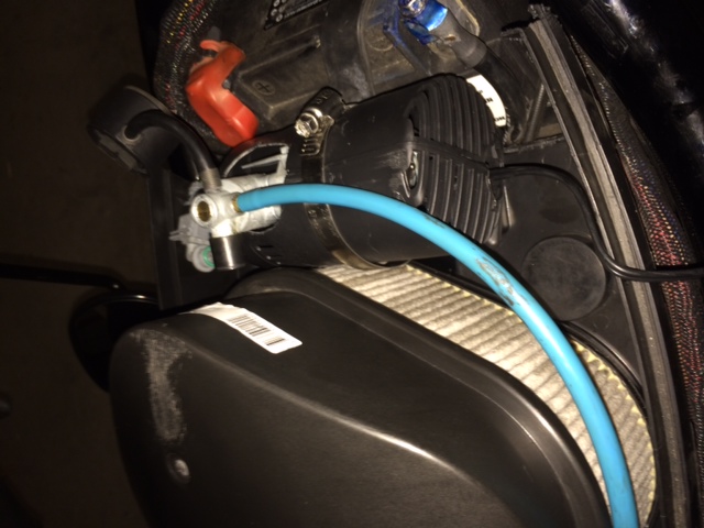

    i then drilled a few holes in the bottom plate where i can use to attach my clamps for compressor(see pics)
    I was a bit funny on the whole changing position of the IAC sensor, but i found a great spot for it by drilling some 3mm holes to use for zip ties.

    checkout the pics. take note of the IAC sensor position.
