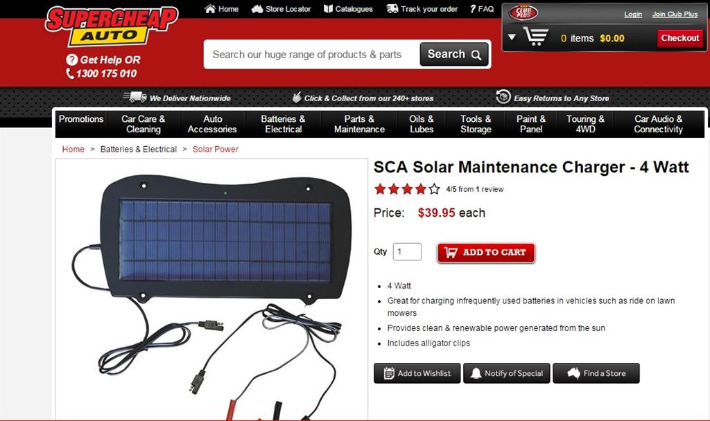

    juist my 2 cents  but research shows that when a battery gets below 12v it deteriorates quickly, I currently use a solar panel (providing you have access to daylight) that you can buy from Supercheap and other places
    are free to run and cheaper than a trickle charger
    The Harley alarm system uses around 100mA while the bike is off so you need a solar panel etc that puts out a minimum on 200mA plus
    I have run one on my vstar 650 and it is an 08 model and runs the original battery still,  Also run one on boat and can be 9 months between starting

    had a guy at work with a 91 softail custom that has it in storage and going to do a refurb on it saying he is putting a battery in it every year, told him about the solar panel , its 3 years and still on same battery after 3 years
