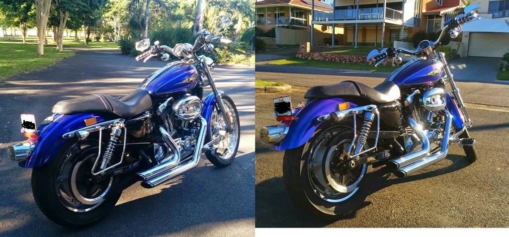

    Before and after photos here
  • 92Fatboy
    92Fatboy
    doesn't look any different ?
  • ricespice
    ricespice
    The stock is:
    Center Width: 4.75″
    Design: Diamond knurled
    Diameter: 1″
    Drilled for Wiring: No
    Finish: Chrome
    Pullback: 7.5″
    Rise: 4.5"
    Width: 27″
    So the difference isn't too drastic, but in person it's noticeably wider than it was and I'm happy with it for now considering it only cost $100.
