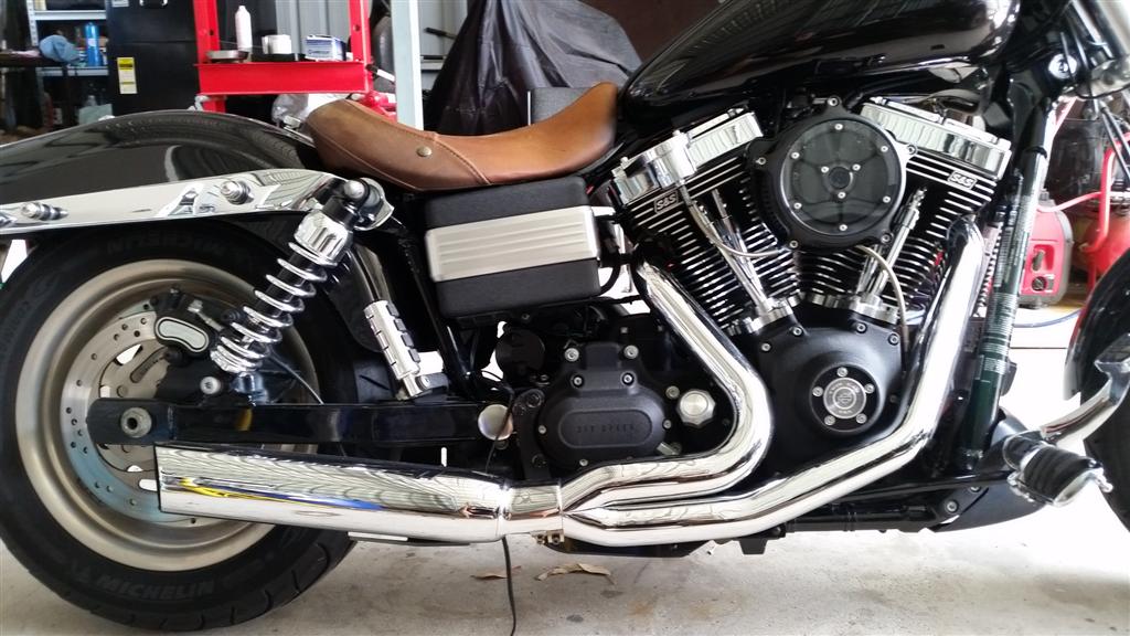

    Some pipes will fit. Just look out for your oil fill point for clearance.
    A mate and myself fitted these in an afternoon while having a few beers.
    They tuck into the engine real nice give plenty of clearance round the dipstick.
    I had to make a new rear bracket so I made it a little more heavy duty.
    The effort is well worth it some real nice pipes out there for softails.
